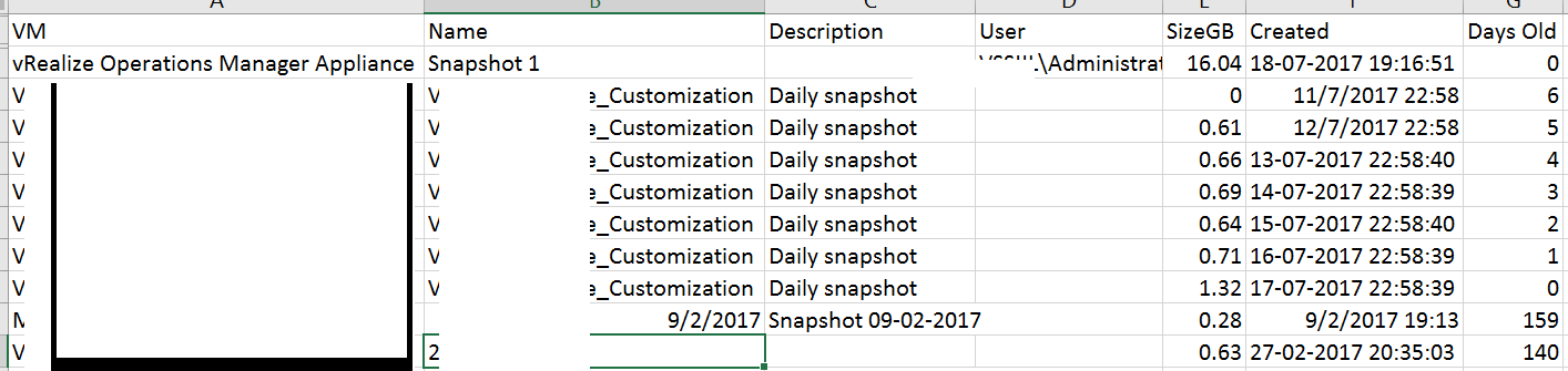

    I am beginner to scripting, don't know its in deep but I try to make some tweaks to get what I want. Goal to being here is gain and share knowledge, not for points.
    I used below script, getting most of the things you need except VMHost. I am still checking this further.
    $Report = Get-VM |
        Get-Snapshot |
        Select VM,
        Name,
        Description,
        @{Name="User"; Expression = { (Get-VIEvent -Entity $_.VM -Start $_.Created.AddSeconds(-10) | Where {$_.Info.DescriptionId -eq "VirtualMachine.createSnapshot"} | Sort-Object CreatedTime | Select-Object -First 1).UserName}},
        @{Name="SizeGB";Expression={ [math]::Round($_.SizeGB,2) }},
        Created,
        @{Name="Days Old";Expression={ (New-TimeSpan -End (Get-Date) -Start $_.Created).Days }} | Export-Csv C:\Reports\Snapshotreport.csv
    The results are like this..
