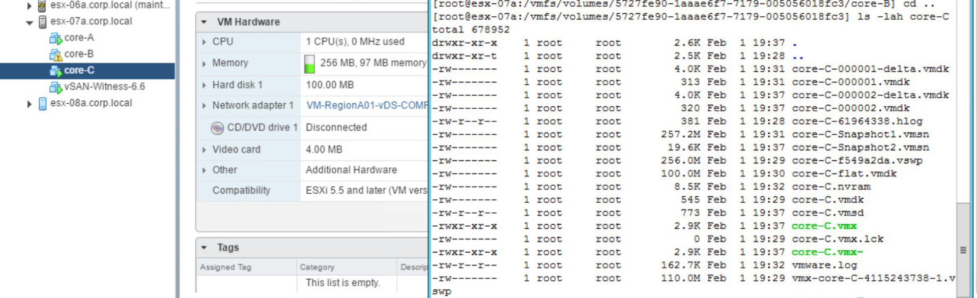

    Basically if you create a non-memory snapshot the .vmsn file associated with that snapshot will be relatively tiny - 19.1KB in size in 6.6  (do check default size in whatever version you are running or just assume any in KB range do not have memory) while those with memory have a .vmsn file approximately the same size as the memory attached to the VM (regardless of memory reservation).
    Below is an example of a VM with 256MB memory with 2 snapshots taken, Snapshot1 with memory, Snapshot2 without memory:
