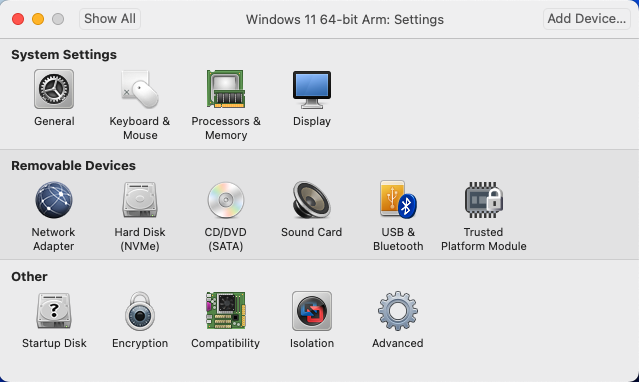

    after having successfully installed Windows11 ARM on my MacMini M2 and installed the VMWare Tools, i can't see any shared folder between the VM and the Mac.
    and when i open the VM settings, there is no "Sharing" option showing up.
    Did I miss some step in the Install Process?
    And is there a way to have this option showing up?

    The Folder Sharing option is not available for a Windows 11 ARM VM. Consider one of the following workarounds to share files between the Mac host and a Windows 11 ARM VM:
    • Configure macOS Windows file sharing.
    Consult macOS Help – found in the Finder's Help menu bar – or Internet resources for instructions on how to configure macOS Windows file sharing. Enable file sharing for the folders you wish to access in your VM. This will allow the Windows VM to access the host via standard Windows SMB file sharing.
    This workaround should only be used when connected to a trusted network such as a home network. The use of macOS file sharing when connected to an untrusted network – such as public or hotel Wi-Fi – is a security risk. To mitigate this risk, disable file sharing in macOS when connected to an untrusted network.
    • Use Drag and Drop.
    For simple file transfers between host and guest, consider dragging and dropping files between the Mac host and Windows 11 ARM guests. The speed of drag/drop has been noticeably increased over prior versions of Fusion (even on Intel) and may meet your needs if they don't include syncing folders with the host.
    • Use a Remote Desktop client.
    If using Windows 11 Pro or Enterprise, you can access the VM with a Remote Desktop Protocol (RDP) client such as Microsoft Remote Desktop on the Mac and utilize its folder redirection capabilities. Consult Windows documentation on how to configure Windows for remote console access, and your RDP client documentation on how to enable folder redirection.
    • Install Microsoft OneDrive, Dropbox, or a similar cloud file sharing client in both the VM and the Mac.
    Using cloud file sharing services in a VM allows content to be shared to Macs and any other platform that supports the service.
    • Use a network file transfer utility such as WinSCP to transfer files between the Windows VM and the Mac host.
    - Paul (technogeezer)
