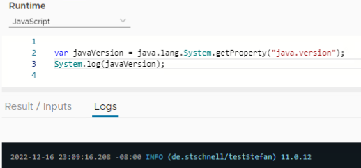

To find a way to detect the used Java version I would like to use the following script:
// Begin----------------------------------------------------------------
var javaVersion = java.lang.System.getProperty("java.version");
System.log(javaVersion);
// End------------------------------------------------------------------

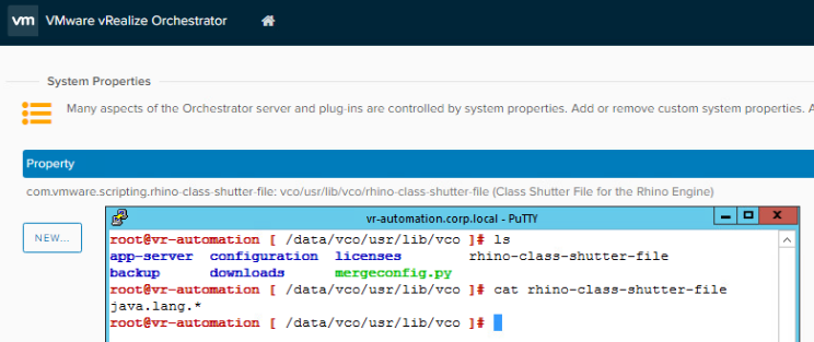

1. Create file with name rhino-class-shutter-file in the directory /data/vco/usr/lib/vco.
2. Set system property com.vmware.scripting.rhino-class-shutter-file to vco/usr/lib/vco/rhino-class-shutter-file. This configuration is stored in the file vmo-managed.properties in the location /data/vco/usr/lib/vco/app-server/conf.
Different file names were tried, e.g. java_shutter_file or rhinofile. Furthermore different notations of the paths were tried out, like vco/usr/lib/vco/app-server/conf/rhinofile, /vco/usr/lib/vco/app-server/conf/rhinofile, data/vco/usr/lib/vco/app-server/conf/rhinofile, /data/vco/usr/lib/vco/app-server/conf/rhinofile etc. This was tested with version 8.5.1 and 8.9.0.

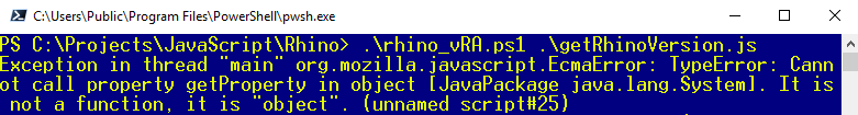

3. After the restart of the Orchestration service and an new login into the vRA the error message 'TypeError: Cannot call property getProperty in object [JavaPackage java.lang.System], it is not a function, it is "object"' occures.
This is exactly the same error message as in a simulation where the ClassShutter is set on the same way.

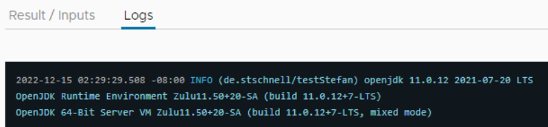

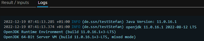

As far as I can see uses the Orchestrator 8.5.1 the Azul JDK Zulu 11.0.12.
