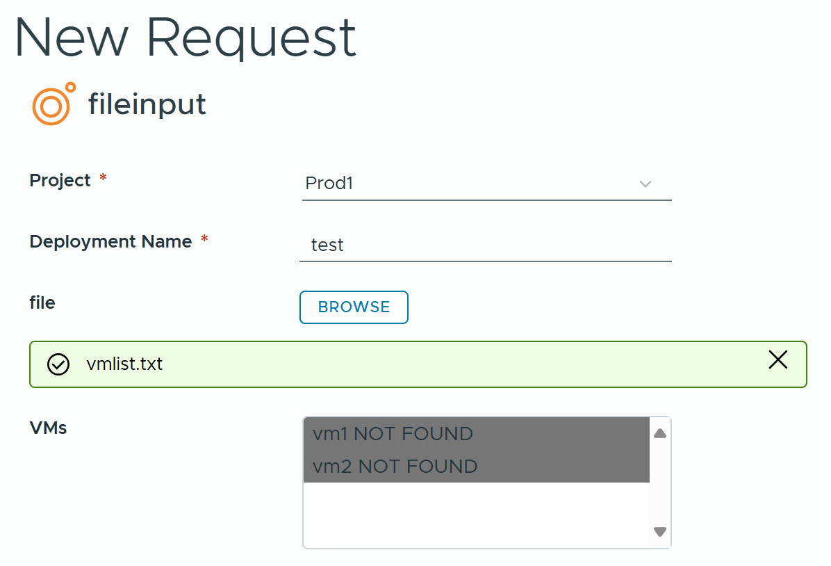

    Based on that I was able to compile what @SistDip wanted. Here is the combined code:
    if (!file) return [];
    var fileJson = JSON.parse(file);
    var fileName = fileJson.label;
    var fileValue = fileJson.value;
    var b64content = fileValue.substring(fileValue.lastIndexOf(',') + 1);
    var inputfile = new MimeAttachment();
    inputfile.buffer = new ByteBuffer(b64content);
    var fileContent = inputfile.content.split(/\r\n|\n/)
    vmWithError = new Array()
    for each (var vmName in fileContent) {
        //System.log("vmName > " + vmName)
        var found = Server.findAllForType("VC:VirtualMachine", "xpath:name='" + vmName + "'")
        //System.log(found.length)
        //check if the inserted vm exists or not
        if ( found.length == 0) {
            System.log(vmName + " NOT FOUND")
            vmWithError.push(vmName + " NOT FOUND")
    if ( vmWithError.length == 0 ) {
        vmWithError.push("Check VMs SUCCESSFULLY Completed")
    return vmWithError.sort()
    The input of this action is String, output is Array of String. I have added it to the custom form, but could bind it to the file input by manually adjusting the form yaml:
      file:
        label: file
        type:
          dataType: file
          isMultiple: false
      multiSelect_cb2a17e7:
        label: VMs
        type:
          dataType: string
          isMultiple: true
        valueList: []
        constraints: {}
        default:
          type: scriptAction
          parameters:
            - file: file
              $type:
                dataType: string
                isMultiple: false
    Here is how it looks like once the file is uploaded:
    I found one drawback: even if a new file is uploaded, the Array below is not refreshed.
