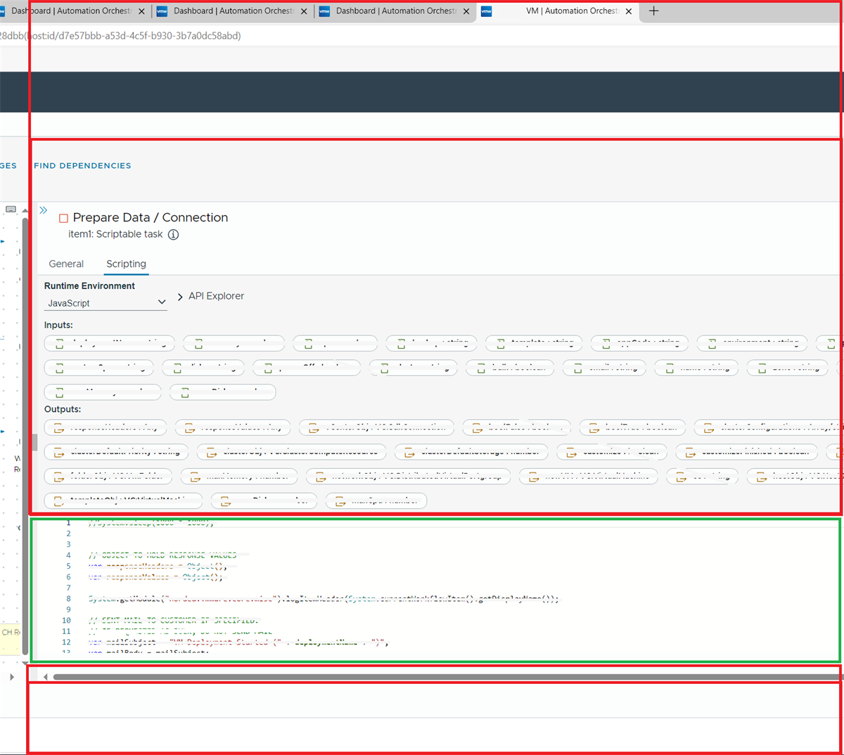

    Hello,
    my everyday is in the Orchestrator, currently on 8.18.1. The product / editor has indeed gotten great improvements since version 8 first arrived.
    But I really struggle with a development tool, where the actual development / coding is so limited. As an example, I have uploaded a picture of one of my code items. Picture is taken on a screen with resolution on 2440 x 1440 (only the right half part of the UI). The item has some input and out variables, and a monster header and footer, with pretty much no useful information, only a waste of space for the scripting area. I would consider the red areas "waste" and the green area the important stuff, which only covers 1/5 of the screen. I really lack more area to read and write code. I am so limited to this small area; I wish it could run in a separate or popped out windows, maybe even external editor.. Image there were even more variables - then I would have no option to do code..
    Do any of you know how I can improve with view, or how do you do it - do you suffer with the same, or dont you see it as an issue?
