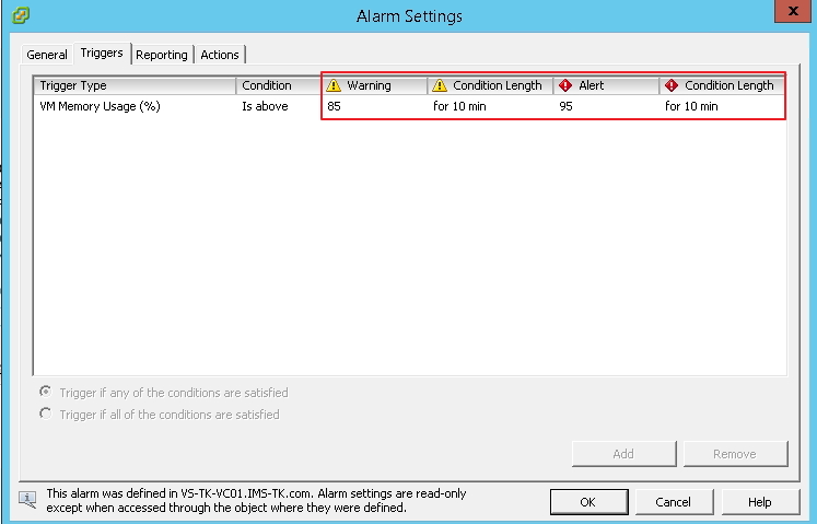

    Specifically, I am looking for a way to get it to set the Warning and Alert values, and set the Condition Length for each.
    Through other posts and thanks to LucD and this post (http://www.lucd.info/2009/11/27/alarm-expressions-part-2-event-alarms/) I am able to get the alarm to create, however, I cannot figure out how to change the Alarm Type from "Monitor for specific events occurring..." to "Monitor for specific conditions or state..." and the subsequent trigger values as necessary such as shown in the picture attached.
    Is this even possible via script?
    Any help would be GREATLY appreciated. Thanks in advance!

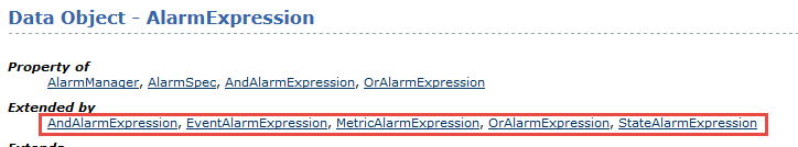

    There are several types of expressions available when setting up alarms.
    It looks as if you want to use the MetricAlarmExpression in this case.
    I have another post on this type of expression, see Alarm expressions – Part 1 : Metric alarms
    The trick with metric alarms, is that the counter id can be different in each vSphere environment.
    The script could like this, but make sure to check the CounterID first !
