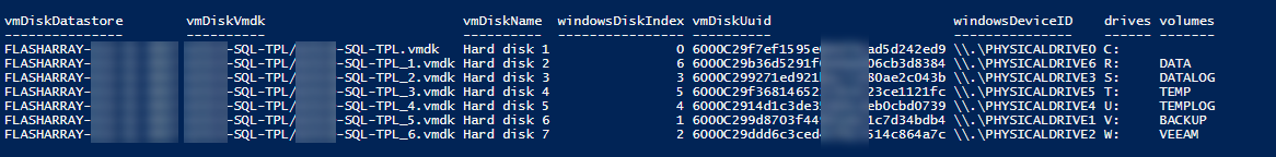

     Running this produces a result like this:

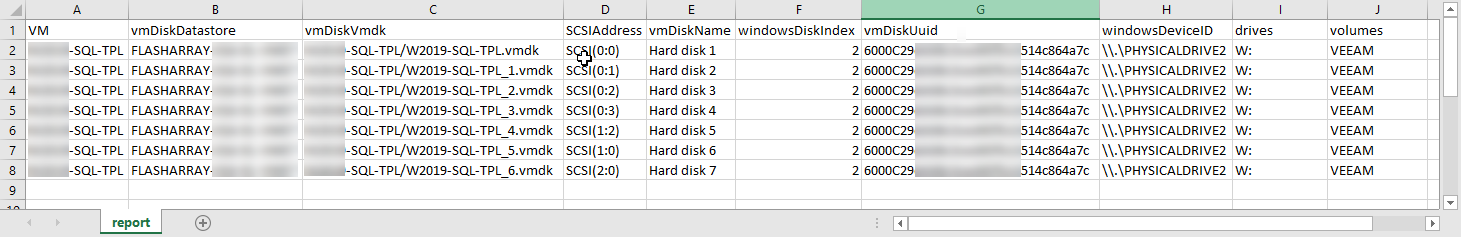

     That produces the following result:

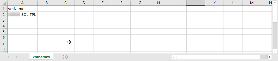

    # CSV file with a column named vmName
    Import-Csv -Path .\vmnames.csv -UseCulture -PipelineVariable row |

    So I modified the $user and $pswd values with the appropriate credentials. I created a vmware.csv file in the same directory that this script resides. I created a column "vmName" and I put one of the servers I want to run it against in that column.

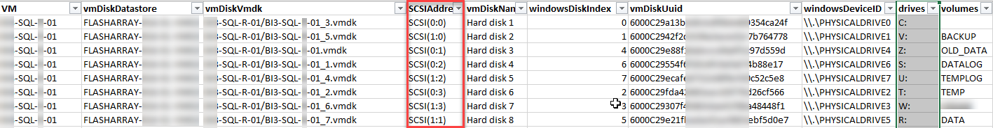

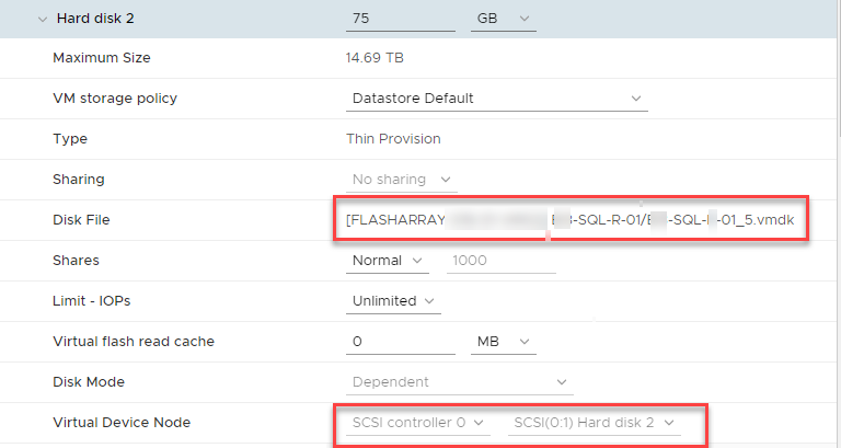

     So I ran it against a few machines and manually checked the results. I found that while it lists the SCSI controller addresses on the VM they are not properly matching to the VM Hard Disks. All other information is correct.
    Here is the export from the script I got from you:
    In the export is shows Hard Disk 2 as using SCSI (1:0) but when I manually checked in VMware Settings is shows that Hard Disk 2 is actually using SCSI (0:1)
    I even made sure that the export was showing the same VMDK disk as in settings and it is.
    If I run the two original scripts I had where I do the Mapping and Lists the SCSI controller addresses separately it does match up to what is in VMware settings.
    Do you think I'm trying to do too many things at the same time with one script and should keep the two queries separate or do you think there's an easy fix for this? If you think I should separate them into two scripts how can I get the desired effect of having an input file and export file for each separate script?

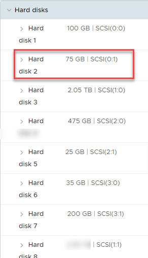

     so I ran the script against a few VMs and I'm noticing that the SCSI Controller Address isn't matching up.
    For example, If you look at Hard Disk 2 the export says it's using SCSI (1:0) but it's actually using SCSI (0:1)
    I even checked the VMDK to make sure that was matching correctly on the Export and it is.
    All of the other information on the export is matching up properly. I even ran the original two scripts I mentioned and it too gave me the correct results of 0:1 for Hard Disk 2.
    Is there an easy fix for this or do you think I'm trying to do too much with one script? If I need to run them as two separate scripts how can I have the same desired effect of having an input file with the list of servers and an export with the Server Name and the SCSI addresses?
  • 10.  RE: Script to Map Windows and VMware Disks as well as VMware SCSI Controller configuration
    Posted Nov 24, 2020 06:47 PM
    My bad, I just noticed that I swapped the controller and the disk in the SCSI address.

  • 11.  RE: Script to Map Windows and VMware Disks as well as VMware SCSI Controller configuration
    Posted Nov 24, 2020 07:01 PM
     Yup. That was it. Awesome. Last question and I'll stop bugging you. If I wanted to add the Hard Disk Sizes to a column on the export as well what would I need to change in the script?
    I assume I have to add the values here but I'm not 100% sure what the values that need to be added and how the formatting needs to be changed.
    $curDiskMap = "" | select vmDiskDatastore, vmDiskVmdk, SCSIAddress, vmDiskName, windowsDiskIndex, vmDiskUuid, windowsDeviceID, drives, volumes
                $driveVolumes = $diskToDriveVolume | where {$_.Disk -eq $windowsDisk.DeviceID}
                New-Object -TypeName PSObject -Property ([ordered]@{
                    VM = $vm.Name
                    vmDiskDatastore = $vmDisk.filename.split(']')[0].split('[')[1]
                    vmDiskVmdk = $vmDisk.filename.split(']')[1].trim()
                    SCSIAddress = "SCSI($($ctrl.BusNumber):$($vmDisk.ExtensionData.UnitNumber))"
                    vmDiskName = $vmDisk.Name
                    windowsDiskIndex = if ($windowsDisk){$windowsDisk.Index}else{"FAILED TO MATCH"}
                    vmDiskUuid = $vmDiskUuid
                    windowsDeviceID = if ($windowsDisk){$windowsDisk.DeviceID}else{"FAILED TO MATCH"}
                    drives = $driveVolumes.DriveLetter
                    volumes = $driveVolumes.VolumeName
  • 12.  RE: Script to Map Windows and VMware Disks as well as VMware SCSI Controller configuration
    Posted Nov 24, 2020 07:15 PM
    No problem, add this line
    vmDiskSizeGB = $vmDisk.CapacityGB

    Make sure when you're running the PowerShell script that you are in the working directory first where the vmnames.csv file resides. Otherwise it'll complain it can't find the vmnames.csv file. All of the VMs you want to run this against need to go in this file. This will also be the same directory that the report.csv exports to.
    You can do a search and export the list of VMs from the Virtual Machines view in vCenter so you don't have to type them all out by hand if you have a lot.

  • 17.  RE: Script to Map Windows and VMware Disks as well as VMware SCSI Controller configuration
    Posted Jun 23, 2026 11:39 PM
    I'm getting a blank "report.csv" Any ideas?

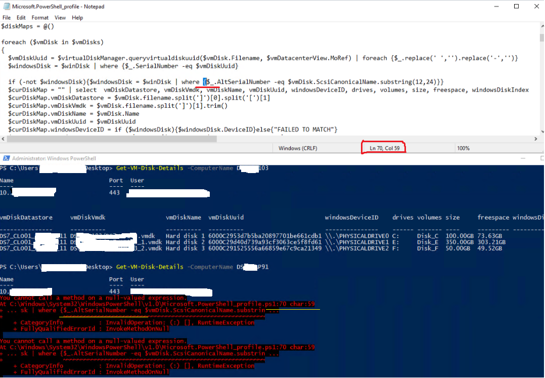

  • 19.  RE: Script to Map Windows and VMware Disks as well as VMware SCSI Controller configuration
    Posted Sep 21, 2023 01:42 PM
    Hi
    When I try to run the script, getting below errors:
    You cannot call a method on a null-valued expression.
    At C:\Users\XODXCAKUppu\Desktop\vdisk.ps1:69 char:50
    + ... sk | where {$_.SerialNumber -eq $vmDisk.ScsiCanonicalName.substring(1 ...
    + CategoryInfo : InvalidOperation: (:) [], RuntimeException
    + FullyQualifiedErrorId : InvokeMethodOnNull
    Kindly assist to fix. thanks,
    Reach me @ k_anandhan@hotmail.com or skanandhan@gmail.com
  • 20.  RE: Script to Map Windows and VMware Disks as well as VMware SCSI Controller configuration
    Posted Sep 21, 2023 02:15 PM
    Which script and which line?
    I can't find the line mentioned in the error message
  • 21.  RE: Script to Map Windows and VMware Disks as well as VMware SCSI Controller configuration
    Posted Sep 21, 2023 02:22 PM
    Mapping VMWare vmdk disk to OS Disk mapping script.
    The last line : $_.AltSerialNumber - giving error
    #Getting a disk serial number
    foreach ($disk in $winDisk)
    $disk | Add-Member -MemberType NoteProperty -Name AltSerialNumber -Value $null
    $diskSerialNumber = $disk.SerialNumber
    if ($disk.Model -notmatch 'VMware Virtual disk SCSI Disk Device')
    if ($diskSerialNumber -match '^\S{12}$'){$diskSerialNumber = ($diskSerialNumber | foreach {[byte[]]$bytes = $_.ToCharArray(); $bytes | foreach {$_.ToString('x2')} } ) -join ''}
    $disk.AltSerialNumber = $diskSerialNumber
    #Searching all VM disks and matching them with Windows disks by their SerialNumber / UUID
    $diskMaps = @()
    foreach ($vmDisk in $vmDisks)
    $vmDiskUuid = $virtualDiskManager.queryvirtualdiskuuid($vmDisk.Filename, $vmDatacenterView.MoRef) | foreach {$_.replace(' ','').replace('-','')}
    $windowsDisk = $winDisk | where {$_.SerialNumber -eq $vmDiskUuid}
     if (-not $windowsDisk){$windowsDisk = $winDisk | where {$_.AltSerialNumber -eq $vmDisk.ScsiCanonicalName.substring(12,24)}}
    ======== Output ===
    At C:\Windows\System32\WindowsPowerShell\v1.0\Microsoft.PowerShell_profile.ps1:926 char:59
    vmDiskDatastore vmDiskVmdk vmDiskName vmDiskUuid windowsDeviceID drives volumes size freespace windowsDiskIndex
    DS7_CLO01_04 DZAP91/DZAP91_4.vmdk Hard disk 1 6000C29d3c24c0481d7fc608b0ae55e5 FAILED TO MATCH 0.00GB 0.00GB FAILED TO MATCH
    DS7_CLO01_04 DZAP91/DZAP91_1.vmdk Hard disk 2 6000C29264e150ce413ade616404070b FAILED TO MATCH 0.00GB 0.00GB FAILED TO MATCH
  • 22.  RE: Script to Map Windows and VMware Disks as well as VMware SCSI Controller configuration
    Posted Sep 21, 2023 02:28 PM
    The script is not working Windows Server 2016 & above OS version, getting the same error. But it is working for Windows Server 2012 r2 and below.
  • 23.  RE: Script to Map Windows and VMware Disks as well as VMware SCSI Controller configuration
    Posted Sep 21, 2023 02:58 PM
    The error message says "$_.SerialNumber", not "$_.AltSerialNumber".
    Did you check your code?
  • 24.  RE: Script to Map Windows and VMware Disks as well as VMware SCSI Controller configuration
    Posted Sep 21, 2023 03:30 PM
      |   view attached
    Hi,
    I have modified the script as function, the majority of your part is unchanged.
    But still getting the same error.
    Please find attached the script file.
    Kindly review and advise. thanks. Awaiting your reply.
    Attachment(s)
  • 25.  RE: Script to Map Windows and VMware Disks as well as VMware SCSI Controller configuration
    Posted Sep 21, 2023 05:30 PM
    The code you attached does not contain the line mentioned in the error message.
  • 26.  RE: Script to Map Windows and VMware Disks as well as VMware SCSI Controller configuration
    Posted Sep 22, 2023 03:49 AM
    Hi LucD,
    Please find the attached screenshot. When I execute the script for Win2012r2, it works, but above Win2012 I get the error, which points to $_.Altserialnumber line:70,char:59.
    Is it possible can us to connect via Zoom/teams? If yes send an email (skanandhan@gmail.com or anandhank@dxc.com), please much appreciated.
  • 27.  RE: Script to Map Windows and VMware Disks as well as VMware SCSI Controller configuration
    Posted Sep 22, 2023 08:53 AM
    Sorry, I don't do that.
    It would become a full-day occupation if I start doing that.
  • 28.  RE: Script to Map Windows and VMware Disks as well as VMware SCSI Controller configuration
    Posted Sep 22, 2023 09:00 AM
    Np,
    Could you please help me on the script? Did you check the attached snapshots? any suggestion?
  • 29.  RE: Script to Map Windows and VMware Disks as well as VMware SCSI Controller configuration
    Posted Sep 22, 2023 09:25 AM
    As far as I can tell, the error is caused by the Substring method, not the AltSerial property.
    You would have to check what is actually in $vmDisk at that point.
  • 30.  RE: Script to Map Windows and VMware Disks as well as VMware SCSI Controller configuration
    Posted Sep 22, 2023 09:32 AM
    Do you have an alternative script to pull the disk map report for Windows 2019?
  • 31.  RE: Script to Map Windows and VMware Disks as well as VMware SCSI Controller configuration
    Posted Sep 22, 2023 09:38 AM
    No, I don't.
    In fact, there is no foolproof method for mapping vDisks to Windows partitions.
    It only works in certain situations.
    Isn't the Get-VMGuestDisk cmdlet returning part of that information?
    Note that there are some prereqs for that cmdlet to work.
  • 32.  RE: Script to Map Windows and VMware Disks as well as VMware SCSI Controller configuration
    Posted Sep 25, 2023 06:33 PM
    Hi LucD,
    Find the issue. Windows Server 2019 server OS unable to register the disk serial number.
    In another vmware form, found the solution to update the VM property disk.EnableUUID set to True value. Then shutdown and boot the virtual machine. Now it is working.
    Thanks for your help.

    Posted Nov 24, 2020 09:06 PM
    Here is my final version of the script in case anybody wants to reference it:
    Another issue I had was some VMs were affected by a vSphere 6.5 bug where the "disk.EnableUUID = "TRUE" value was missing from multiple vmx configuration files. I'll have to go back and fix that on those VMs.  Without that value the Uuid is not exposed to the Guest OS. Therefore, it can't match the drives up.
    You can reference that KB article here.
    https://kb.vmware.com/s/article/52815
    Finally, As @LucD mentioned. This is not a fool proof method and only works under the right conditions. Your mileage may vary.
    HUGE THANKS to @LucD. I wouldn't have even known where to begin (or end) without his help!
  • 34.  RE: Script to Map Windows and VMware Disks as well as VMware SCSI Controller configuration
    Posted Nov 25, 2020 02:47 AM
    Finally, As mentioned. This is not a fool proof method and only works under the right conditions. Your mileage may vary.
    HUGE THANKS to . I wouldn't have even known where to begin (or end) without his help!

    Posted Jun 24, 2026 12:28 PM
    We have some Microsoft SQL Clusters using Mount Point.  It's possible to get the Mount Point volumes folder name on the windowsDeviceID instead empty,
    VM vmDiskDatastore vmDiskVmdk SCSIAddress vmDiskName windowsDiskIndex vmDiskUuid windowsDeviceID drives volumes
    SQLCLDB01A PROD_DB_SQLA SQLCLDB01A/SQLCLDB01A.vmdk SCSI(0:0) Hard disk 1 0 6000C29fc1a75736524c033681a34cf0 \\.\PHYSICALDRIVE0 C:
    SQLCLDB01A PROD_DB_SQLA SQLCLDB01A/SQLCLDB01A_9.vmdk SCSI(2:2) Hard disk 10 4 6000C296cc31b069e0a903f877d75bdb \\.\PHYSICALDRIVE4
    SQLCLDB01A PROD_DB_SQLA SQLCLDB01A/SQLCLDB01A_10.vmdk SCSI(3:2) Hard disk 11 5 6000C2910394ea230794810e8db8490e \\.\PHYSICALDRIVE5
    SQLCLDB01A PROD_DB_SQLA SQLCLDB01A/SQLCLDB01A_11.vmdk SCSI(4:2) Hard disk 12 6 6000C29b43f4978e0ff4863c571596dd \\.\PHYSICALDRIVE6
    SQLCLDB01A PROD_DB_SQLA SQLCLDB01A/SQLCLDB01A_1.vmdk SCSI(1:0) Hard disk 2 1 6000C293e6f0e6c0d3f226771cd72c16 \\.\PHYSICALDRIVE1 D: DATA
    SQLCLDB01A PROD_DB_SQLA SQLCLDB01A/SQLCLDB01A_2.vmdk SCSI(1:1) Hard disk 3 7 6000C29b82b179b6a6caa2fe8c861d98 \\.\PHYSICALDRIVE7
    SQLCLDB01A PROD_DB_SQLA SQLCLDB01A/SQLCLDB01A_3.vmdk SCSI(2:1) Hard disk 4 8 6000C294bae6fbce61068c65b98bc7c7 \\.\PHYSICALDRIVE8
    SQLCLDB01A PROD_DB_SQLA SQLCLDB01A/SQLCLDB01A_4.vmdk SCSI(3:1) Hard disk 5 9 6000C296c9e69b3da2bd78b449ea8f76 \\.\PHYSICALDRIVE9
    SQLCLDB01A PROD_DB_SQLA SQLCLDB01A/SQLCLDB01A_5.vmdk SCSI(4:1) Hard disk 6 10 6000C29f394a264b45106b2790f01630 \\.\PHYSICALDRIVE10
    SQLCLDB01A PROD_DB_SQLA SQLCLDB01A/SQLCLDB01A_6.vmdk SCSI(5:1) Hard disk 7 11 6000C297bf82920c33caa8d606db72d3 \\.\PHYSICALDRIVE11
    SQLCLDB01A PROD_DB_SQLA SQLCLDB01A/SQLCLDB01A_7.vmdk SCSI(2:0) Hard disk 8 2 6000C29bdb3c658eaaa1b6f7cafb82de \\.\PHYSICALDRIVE2 E: APP
    SQLCLDB01A PROD_DB_SQLA SQLCLDB01A/SQLCLDB01A_8.vmdk SCSI(1:2) Hard disk 9 3 6000C29ac43e13914a9d8e785d21ef5d \\.\PHYSICALDRIVE3
