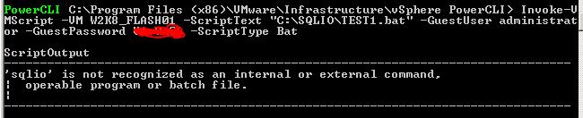

    It seems to be almost working but I get the following output (see image)
    I should also point out I connected PowerCLI directly to the host not vCenter, the batch file I'm trying to run is an SQLIO.exe with the following:
    @ECHO OFF
    sqlio -kR -t8 -s120 -frandom -o32 -b4 -BH -LS -Fparam.txt
  • 4.  RE: Run Batch in Guest Remotely via PowerCLI
    Best Answer
    Posted May 30, 2013 08:14 AM
    It looks as if the sqlio command is not found. Could be that the directory is not in the Path variable in that OS.
    Try with the full path to the sqlio executable.
