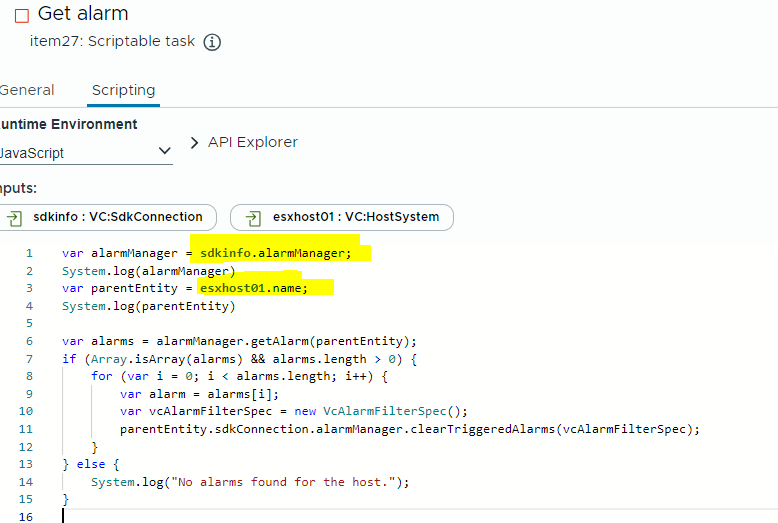

  • 7.  RE: "reset to green" to specific Cluster on my VC
    Posted Dec 24, 2024 10:37 AM
    hi
    thank you for your reply
    I see your script
    but it does not work for me, and I am sure that I was wrong
    I add input
    (sdkinfo.VC:SdkConnection) , and (esxhost01.VC:HostSystem)
    var alarmManager = sdkinfo.alarmManager;
    System.log(alarmManager)
    var parentEntity = esxhost01.name;
    And continue your code
  • 8.  RE: "reset to green" to specific Cluster on my VC
    Posted Mar 13, 2025 12:31 PM
    Hi,
    `parentEntity` cannot be string. Your `esxhost01.name` returns a string. But it has to be an object. Please, try to use the code I did provide without any modifications. It should work.

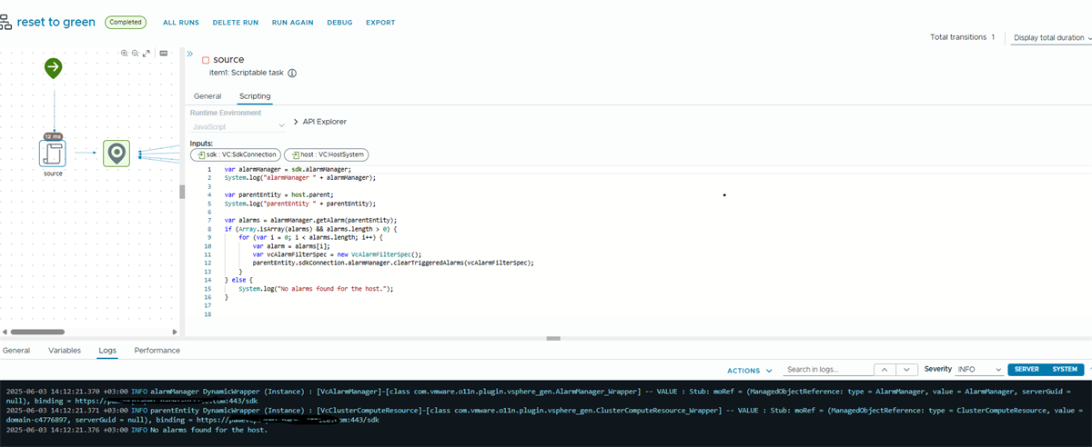

  • 9.  RE: "reset to green" to specific Cluster on my VC
    Posted Jun 03, 2025 09:23 AM
    HI
    Unfortunately it doesn't work
    I took some screenshots
    Maybe you can see my mistake
    thanks

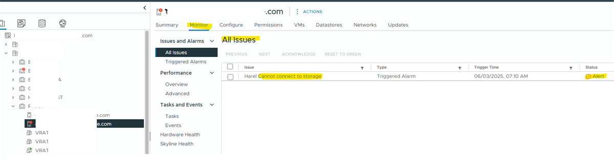

  • 10.  RE: "reset to green" to specific Cluster on my VC
    Posted Jun 03, 2025 10:46 AM
    Hi,
    can you please show/confirm the alarm is set on a cluster level?
    If you find the answer helpful, please click on the RECOMMEND button.
    Please visit my blog to get more information: https://clouddepth.com
  • 11.  RE: "reset to green" to specific Cluster on my VC
    Posted Jun 04, 2025 03:26 AM
    Sorry, can you give me a picture of what you meant
    or give me direction ?
