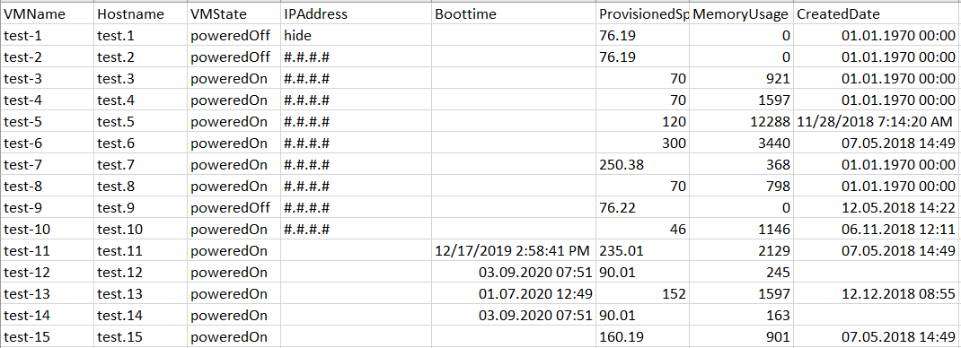

    Without delimiter look the output in Excel(CSV) like this. Do you have English products? some of our colleagues have German products.  VMName,Responsible_Team,Unit,Hostname,VMState,IPAddress,Boottime,PoweredOff,UsedSpaceGB,Datastore,ProvisionedSpaceGB,MemoryUsage,CreatedDate,Backup_Strategy,To_Archive,Creator,OS,Notes pd-mango-esb,,HOLD,,poweredOff,,,,29.57,DS_ITCC_sound_sata,76.19,0,1/1/1970 12:00:00 AM,,,,Microsoft Windows Server 2012 (64-bit), build-fxp-esb-n,,HOLD,,poweredOff,,,,22.82,DS_hold_pd_ssd_1_strong,76.19,0,1/1/1970 12:00:00 AM,,,,Microsoft Windows Server 2012 (64-bit),
  • 13.  RE: Report: The creator of VM, who created the VM?
    Posted Apr 22, 2020 02:46 PM
    That looks pretty normal for a CSV (Comma Separated Values).
    The first row contains the column headers, the other rows are the data.
    Do you have a problem when you open this in Excel (configured for German)?
  • 14.  RE: Report: The creator of VM, who created the VM?
    Posted Apr 22, 2020 03:31 PM
    Not Serious problem, but it's not readable for others like it is not really in the right layout
    Desired output:
  • 15.  RE: Report: The creator of VM, who created the VM?
    Posted Apr 22, 2020 04:38 PM
    Are you still talking only of the cells containing a datetime value?
    When you open a CSV with Excel, it is Excel that will interpret the value in the cell and format it accordingly (and following the formatting used by the 'Culture').
    You could write the file while PowerShell is configured for German, but then I suspect the en-US versions will have problems.

    Yeah, i meant, that cells which have datetime and Numbers with Decimal. (current result: 28.34 and wanted result: 28,34). I have found an alternative solution of datetime, i just configured preferred language of system and its datetime formate. if any script could do these changes, it would be great.
  • 17.  RE: Report: The creator of VM, who created the VM?
    Posted Apr 23, 2020 06:59 AM
    I'm not sure if you can even make a file with content that is adapting to the Regional Settings of the station where the file is opened.
  • 18.  RE: Report: The creator of VM, who created the VM?

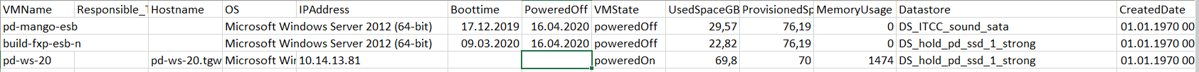

    I have a question: Today I saw in the Report that a VM which was deployed by a user the Script didn't find the User, who created this vm
    What would be the cause?
    this is the code:
    Write-Host "Gathering VM statistics"
    Measure-Command{
    $view = Get-View -ViewType Virtualmachine
    $cnt = 1
    Write-Host "Found $($view.count) virtual machines"
    $events = Get-VIEvent -Entity $view.Name -MaxSamples ([int]::MaxValue) |
            Where-Object { $_ -is [VMware.Vim.VmDeployedEvent] -or
                          $_ -is [VMware.Vim.VmClonedEvent]-or
                           $_ -is [VMware.Vim.VmCreatedEvent]-or
                           $_ -is [VMware.Vim.VmPoweredOffEvent]-or
                           $_ -is [VMware.Vim.VmRegisteredEvent]}
    foreach($vm in $view ) {
        if (!$vm.Config) { continue }
    Write-Host "Processing $($cnt) - $($vm.Name)"
        $vms = [PSCustomObject]@{
          VMName = $vm.Name
      Responsible_Team = ""
          Hostname = $vm.guest.hostname
          OS = $vm.Config.GuestFullName
          IPAddress = $vm.guest.ipAddress
          Boottime = $vm.Runtime.BootTime
      PoweredOff = ($events | where{$_.VM.Name -eq $vm.Name} | Sort-Object -Property CreatedTime -Descending | Select -First 1).CreatedTime
          VMState = $vm.summary.runtime.powerState
          UsedSpaceGB = [math]::Round($vm.Summary.Storage.Committed/1GB,2)
          ProvisionedSpaceGB = [math]::Round(($vm.Summary.Storage.Committed + $vm.Summary.Storage.UnCommitted)/1GB,2)
          MemoryUsage = $vm.summary.quickStats.guestMemoryUsage
          Datastore = $vm.Config.DatastoreUrl[0].Name
          CreatedDate = $vm.Config.CreateDate
          Unit = ""
      Backup_Strategy = ""
      To_Archive = ""
          Notes = $vm.Config.Annotation -replace '(?:\r|\n)',''
          Creator = ($events | where{$_.VM.Name -eq $vm.Name} | Sort-Object -Property CreatedTime -Descending | Select -First 1).UserName
        foreach ($c in $vm.CustomValue) {
         switch ($c.Key) {
            "901" { $vms.Unit = $c.Value }
            "913" { $vms.To_Archive = $c.Value }
            "909" { $vms.Backup_Strategy = $c.Value }
            "904" { $vms.Responsible_Team = $c.Value }
        $Report.Add($vms) | Out-Null
        $cnt++
    $reportName = "C:\Users\Administrator\Downloads\VReport\VMInventory_$(Get-Date -Format 'yyyy_MM_dd').csv"
    $Report | Export-Csv -Path $reportName -NoTypeInformation -Delimiter ";"
    ((Get-Content -Path $reportName |
    ForEach-Object -Process {
         $_ -replace '"', '' })) |
    Out-File -FilePath $reportName -Force -Encoding ascii
    Result: (the result is filtered)
    see the first row Creator is not in the right cell, instead of user is VMWare Perl SDK 6.7.
    and second VM has no creator because it was deployed as i saw in the Vsphere (events and Tasks)
    can you please tell me what would be the cause?
