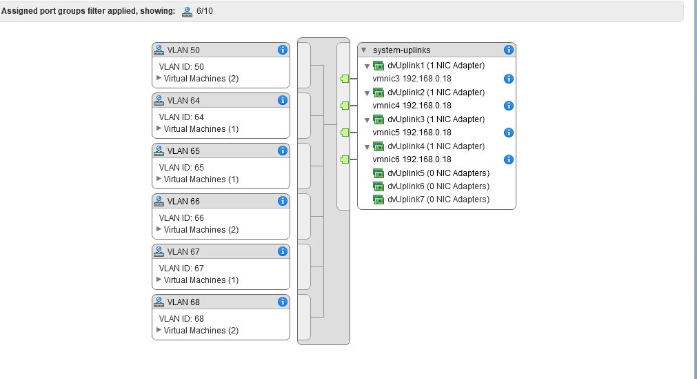

    i recently had a few network changes within my lab environment and i have to decrease my amount of uplink ports on my dvswitch from 7 to 4. i removed the physical nics from the dvswitch but now im left with 3 unused dvUplinks. when i try to reduce the amount of uplinks from the edit settings window on the dvswitch i get a "resource 1707 is in use on host x.x.x.x"
    does anyone know how else i can remove the unused dvuplinks from my dvswitch.
    6.0 vcsa, dvswitch 5.5 (didnt notice until now, will upgrade to 6.0)

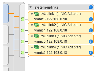

  • 6.  RE: Remove unused DVuplinks for DVswitch
    Posted Oct 26, 2018 05:41 PM
    I'm confused, Uplinks are normally numbered sequentially.
    Do you have empty Uplinks in the sequence?
    Perhaps show a screenshot of the topology to help me understand.
  • 7.  RE: Remove unused DVuplinks for DVswitch
    Posted Oct 26, 2018 06:13 PM
    They are in order, however i have vmnic 1,2 assigned to a standard switch for kernel traffic

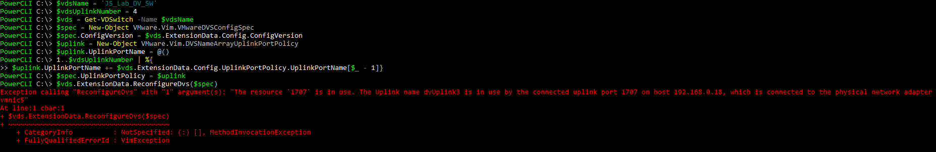

  • 9.  RE: Remove unused DVuplinks for DVswitch
    Posted Oct 26, 2018 06:24 PM
    whoops i pasted it wrong back into the thread. this was the result

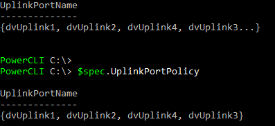

  • 10.  RE: Remove unused DVuplinks for DVswitch
    Posted Oct 26, 2018 06:30 PM
    Ok, can you tell me what these show?
    $vds.ExtensionData.Config.UplinkPortPolicy
    $spec.UplinkPortPolicy
  • 11.  RE: Remove unused DVuplinks for DVswitch
    Posted Oct 26, 2018 08:05 PM
  • 12.  RE: Remove unused DVuplinks for DVswitch
    Posted Oct 26, 2018 08:37 PM
    I'm flabbergasted. That all looks normal and how I expected it to be :smileycry:
    Ok, I think at this point we should have a look at the vpxd log.
    See if you can find the entries from around the time you executed the call to the method.
    On the other hand, since you also seem to get this error when you do the same via the Web Client, I'm wondering if there isn't anything else causing this error.
    The vpxd log could give us some more info on that as well.

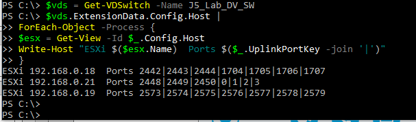

  • 14.  RE: Remove unused DVuplinks for DVswitch
    Posted Oct 29, 2018 06:17 PM
    Correct, not the vpxd profiler logs.
    Could you run the following and check if the mentioned port is in there?
    $vds = Get-VDSwitch -Name <your-vds>
    $vds.ExtensionData.Config.Host |
    ForEach-Object -Process {
        $esx = Get-View -Id $_.Config.Host
        Write-Host "ESXi $($esx.Name)  Ports $($_.UplinkPortKey -join '|')"
  • 15.  RE: Remove unused DVuplinks for DVswitch
    Posted Oct 29, 2018 06:38 PM
    doesnt seem to like your first command
  • 16.  RE: Remove unused DVuplinks for DVswitch
    Posted Oct 29, 2018 06:45 PM
    Just the name of the switch, without the <>
  • 17.  RE: Remove unused DVuplinks for DVswitch
    Posted Oct 29, 2018 06:51 PM
    gotchya, sorry about that.
    it doesnt seem to report anything
    is there a way to identify which dvuplink specifically you want to remove?
  • 18.  RE: Remove unused DVuplinks for DVswitch
    Posted Oct 29, 2018 07:14 PM
    I didn't want to remove anything with that script, just wanted to know to which VDS ports the uplinks were connected for each ESXi node.
    The script wasn't finished in your run (that is what the >> mean).
    Type } followed by <enter>, and then another <enter>

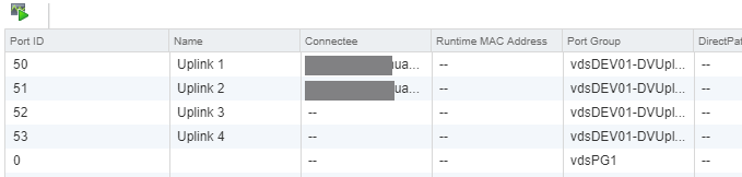

  • 20.  RE: Remove unused DVuplinks for DVswitch
    Posted Oct 29, 2018 07:31 PM
    Can you check on the VDS in the port list with the Web CLient, what is connected to port 1707?
    In other words, is there anything in the Connectee column for port 1707?
  • 21.  RE: Remove unused DVuplinks for DVswitch
    Posted Oct 29, 2018 08:30 PM
    there is, however that is not the dvuplink i would like to remove...
    i want to remove dvuplink 5,6,7
  • 22.  RE: Remove unused DVuplinks for DVswitch
    Best Answer
    Posted Oct 29, 2018 08:34 PM
    Ok, now I have a clear picture of the issue.
    Your Uplinks are not in order, it says Uplink1, Uplink2, Uplink4, Uplink3.
    And the Uplinks are connected to the last 4 ports that are reserved for Uplinks.
    This is probably due to changing/removing Uplinks in the past.
    I will now have to find a way to link the Uplinks to the correct ports, and do the removal in the correct order.
