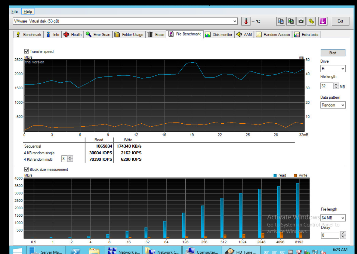

    Hi All,  just started VSAN performance testing and by HD tune pro tool file bench mark testing, I found VM with RAID 1 policy is showing higher read and write IOPS  than RAID 5 policy IOPS (the same VM) where traditionally the RAID 5 read/write performance supposed to be higher than RAID 1. before I move further, I would like to understand this result.
    RAID 1 out put:
    RAID 5 output:
    setup is 4 X DL380 G9 server and 2X10Gbps LACP VSAN network

    No, it's actually opposite. Traditionally, RAID5 writes are always slower than RAID1 because the parity has to be computed and written as well. Reads however are faster on RAID5, because you can read sequentially from all drives at once.
    Your result screenshots show exactly this behavior: With RAID5 your reads are faster, while your writes are slower.
    So these are perfectly in line with what is well known in the storage industry since decades.

    yes write wise correct. how about random reads? and more over I noticed that the results are changing over  multiple re-test with same parameters. may be I will use different tools and compare the data with each other.
