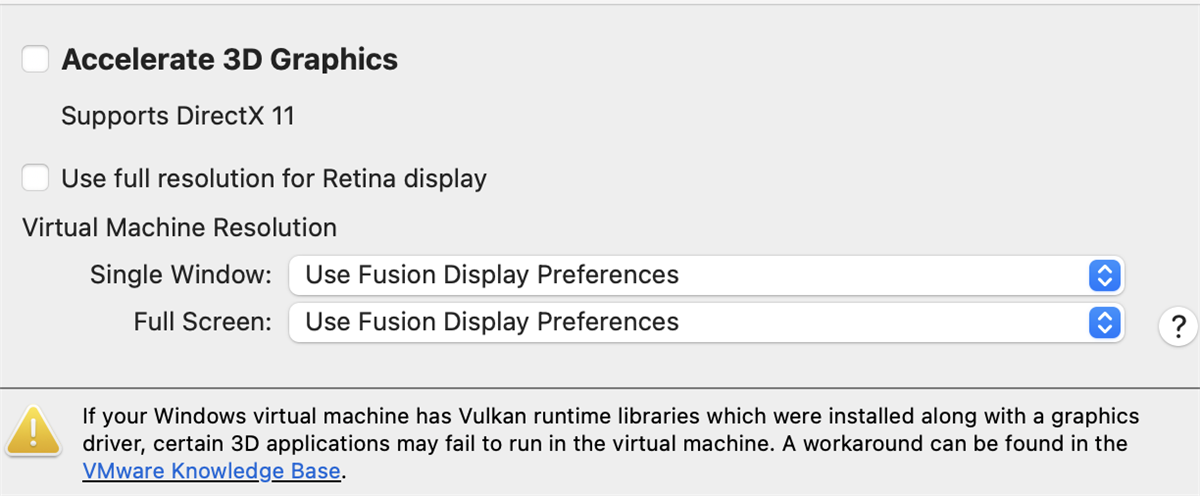

    Question 1: I know the Fusion settings for my VM warns me if I exceed # of cores. I've run in at the safe level of 4 (out of 8) and I've run it higher. The **** question I have is: will my performance on the Windows VM be faster (processing audio effects for instance) with more than 4 cores assigned? I figure I risk taxing my system by using too many cores, but wondering if it really makes a difference on the process performance of rendering and saving files if I assign it more cores.  (Note: I have turned off "Accelerate 3D Graphics" as well as "Use full resolution for Retina Displays" in hopes of maximizing process power and being ok with less-than-crisp graphics as a tradeoff).

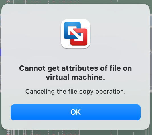

    Question 2: When switching from an active VM session to another app or window on Mac (such as when using CMD+Tab for application switching), I will frequently get this error blinking back over on the VM:
    What does that mean? What did it think I tried to do? And I've let it blink for a long time while doing other work on MacOS - only to come back to VM and it had seemingly paused any processes or progress being done until I clicked OK. I'm wondering if there is a conflicting keyboard shortcut, something close to CMD+Tab...

    I also think that since the 3D acceleration code is a bridge to Apple's GPU assisted Metal, I'd leave that enabled so that graphical displays get a boost. Again. try it on and off and measure what you're seeing. If your code is CPU intensive vs graphics intensive, I woudn't think that 3D support would be an issue.

    Re: 2
    That's an interesting dialog. I wonder if there's something up with keyboard mappings. I'll have to see if I can reproduce what you're seeing.
    - Paul (technogeezer)

    re: 2 -- I will keep an eye open for any other clues. I don't seem to have the issue when I use the CTRL+CMD keyboard short cut to pop the mouse out of the VM window.

    True! Hey, back on the first question about the Graphics options ... I'll give the 3D Acceleration a try again. What's your opinion of the other option regarding "full resolution for retina" (which I do have)?
