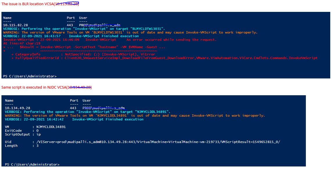

    We have two vCenters BLR and NJDC. When I have executed the below script ,it is working in NJDC VC and not working in BLR VC.Please find the reference screenshots.

    Can you help with this? We have already allowed port 902.when run the below script for one of VCSA.it is not showing output.error screen.PNG
  • 8.  RE: PowerCLI Invoke-VMScript Error
    Posted Oct 01, 2021 09:30 AM
    Try the same with my Invoke-VMScriptPlus function and use the Verbose switch.
    It might provide more feedback.
