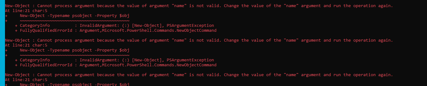

    Thank you once again for a speedy reply. I get the following message onscreen:
    The csv reads:
    I thought it was because of an inconsistancy in variable: VM = $vmName vs $name later in the code. The output was the same when I made the switch to:

    That should have been $vm.Name.
    I corrected the code above.
    For the CSV creation, I corrected the creation of the object.
    The error seems to indicate that you double entries in the Notes.

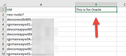

    The csv generated this time around only had a list of VM names. No notes. As well there were only 1627 rows (VMs) in the csv. It's entirely possible to have some VMs with no notes whatsoever. The error/message below generated on screen during the running of the script.
    I checked my command line to see what the variables gave me for output. This particular VM did not appear on the CSV. I've tried to find a pattern of why one vm name appears on csv vs another and I can't see one. It seems random but that's atypical for your coding. I'm perplexed for sure.
    **Addition to above: I just noticed this is in the csv. Not sure why there is a column header "This is for Oracle".

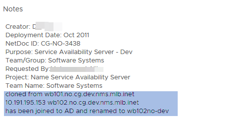

    I get this for each VM that has notes with blank lines between rows of information.
    This is the corresponding notes:

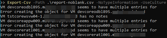

    My guess is the blank lines are being viewed as a multiple entry. I am willing to clean up the valid mulitple entry but yikes!! Tons of VMs with blank rows, and tons without. In the meantime, I'll start the cleanup of valid duplicate data.
    No red errors this time. Just script output. :smileyhappy:  Progress, I'd say.

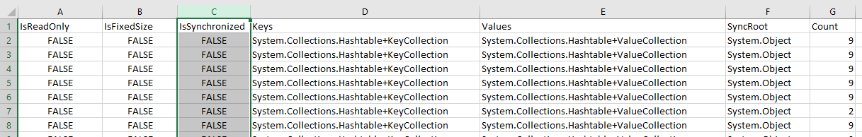

    Well that gave me an interesting csv. I'm guessing I put your suggestion in the wrong place.

    How about we ask for those lines in notes that have verbiage with a colon separator? From the looks of it, someone has filesystem information recorded in notes. Skip everything that isn't prefaced with  XYZ:  (XYZ could be anything as long as it's followed by a colon).
