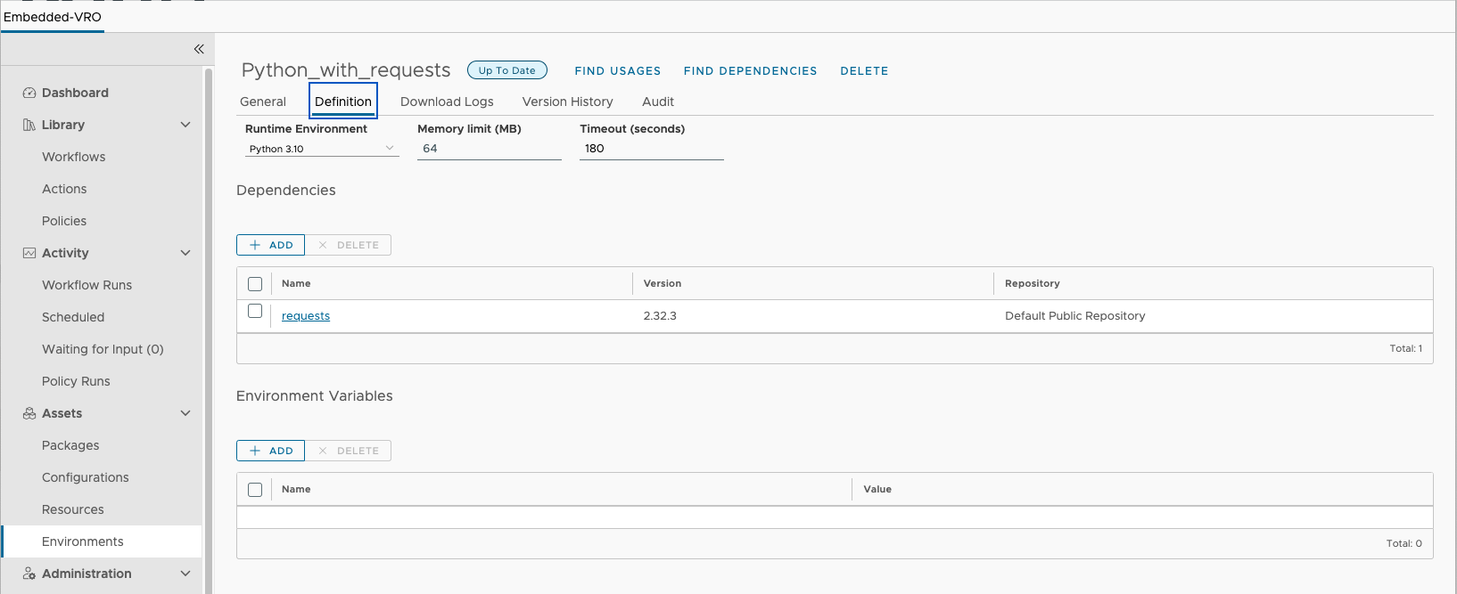

    An Orchestrator script environment for Python was created with Python module "requests" as dependency successfully.
    Then, a scriptable task uses the new Python runtime environment to send an HTTP request as shown below:

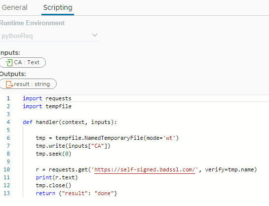

    What I suggest instead is to pass the certificate bundle as an input to your scriptable task. You can store it as a resource element, for example. This is what the IPAM plugin does too: passes the cert bundle each time the actions are run.
    Something like this (you need to save the bundle into a file):
    import requests
    import tempfile
    def handler(context, inputs):
        tmp = tempfile.NamedTemporaryFile(mode='wt')
        tmp.write(inputs["CA"])
        tmp.seek(0)
        r = requests.get('https://self-signed.badssl.com/', verify=tmp.name)
        print(r.text)
        tmp.close()
        return {"result": "done"}

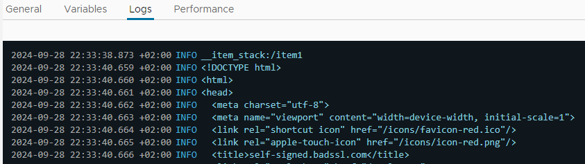

    And the result:
    I have defined "CA" as a workflow input (for the sake of simplicity) and allowed line-breaks with Text area:
    But again, this is just for testing purposes, you can/should store your cert chain somewhere in vRO.

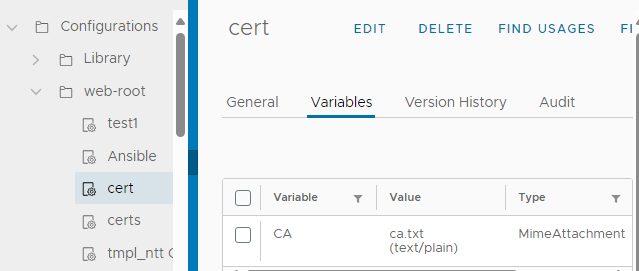

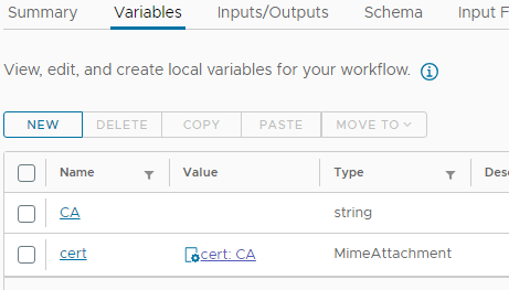

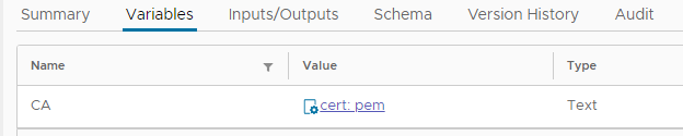

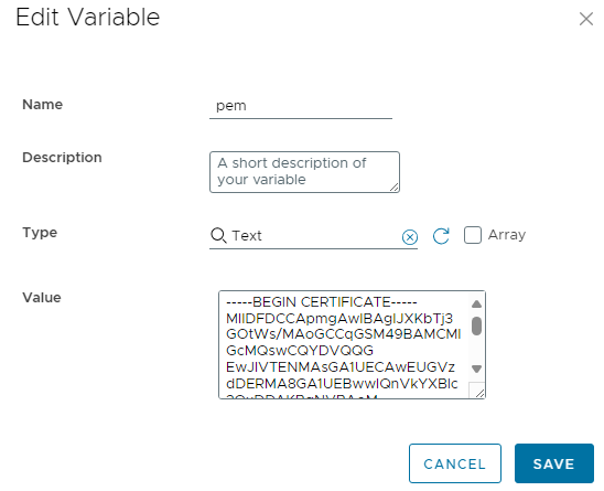

    I have not tested IPAM plug-in yet, but the idea of passing the CA file as an input of the scriptable task is simply great!
    What I am testing now is creating a variable with the CA certificate within a Configuration Element as a string.
    Then, varCertificateManagerCA is an input in the scriptable task.
    However, after testing the following code:
        ca_file = inputs.get("varCertificateManagerCA")
        tmp.write(ca_file)
        tmp.seek(0)
        response = requests.post(url, headers=headers, params=parameters, json=payload, verify=tmp.name)
    I get this error "ssl.SSLError: [X509: NO_CERTIFICATE_OR_CRL_FOUND] no certificate or crl found (_ssl.c:4149)" as shown below:

    Unfortunately the line breaks cannot be saved in a string conf element attribute, and the certificate is not recognized this way by the Python code. That is why I created a string input with a multiline form, not to lose line breaks. Since this workaround not suitable for production cases, you need to choose the MimeAttachment type:
    You need to bind this to a variable in your workflow. You have to "read" this MimeAttachment file and put the content into a string variable (CA):
    You need a Javascript task for that:
    Then you can use this string (including linebreaks) as a cert file in your Python code (second task in the WF).
  • 5.  RE: Orchestrator script environment (Python) fails with SSL: CERTIFICATE_VERIFY_FAILED - how to set CA bundle file to verify certificates
    Posted Sep 28, 2024 04:34 PM
    I was today years old to discover an attribute type Text that allows to save linebreaks in a config element attribute, as a string:
    This can directly bound to an attribute, and passed into Python task as input:
    No need to use MimeAttachment:
  • 6.  RE: Orchestrator script environment (Python) fails with SSL: CERTIFICATE_VERIFY_FAILED - how to set CA bundle file to verify certificates
    Posted Sep 29, 2024 12:57 PM
    Dear @Xian,
    I hope you are fine.
    Thank you very much for your two last replies and excuse me for the late reply.
    I tested MimeAttachement file with a JavaScript task following your first recommendation but it did not work.
    Error received was:
    ERRORurllib3.exceptions.SSLError: [SSL: CERTIFICATE_VERIFY_FAILED] certificate verify failed: unable to get local issuer certificate (_ssl.c:1007)
    I tested Configuration element with a Text variable following your second recommendation but it did not work.
    Error received was:
    DEBUG:urllib3.connectionpool:Starting new HTTPS connection (1): cert-manager.com:443
    In both cases the error is the same.

  • 7.  RE: Orchestrator script environment (Python) fails with SSL: CERTIFICATE_VERIFY_FAILED - how to set CA bundle file to verify certificates
    Best Answer
    Posted Sep 29, 2024 02:37 PM
    Edited by antonioaraujo Oct 02, 2024 07:24 AM
    Hi,
    cert-manager.com should not need any CA in Python, as it signed with a trusted CA. The reason I used badssl.org is to demonstrate that if you have a self-signed (or not trusted) certificate chain, you can still make it work in Python with providing the proper cert chain.
    Your case seems to be different, and I suspect that you have a transparent SSL proxy that replaces the original certificate(s), so it becomes untrusted in your Python code.
    I suggest to fetch the certificates of cert-manager.com from the vRA appliance itself, and provide that chain to the Python code. More than likely it will be different (replaced) from what you see in the browser.

  • 9.  RE: Orchestrator script environment (Python) fails with SSL: CERTIFICATE_VERIFY_FAILED - how to set CA bundle file to verify certificates
    Posted Oct 01, 2024 06:14 AM
    Dear Xian,
    Finally, I was able to use Python request module! You were right.
    After fetching the transparent SSL proxy's issuer certificates (starting from Root CA), HTTP request was processed successfully.
    Your recommendation of using a Text variable within an Orchestrator configuration element did the magic! along with the CA bundle :)
    Thank you very much for your support and guidance!
