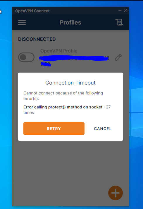

    Windows 10 vmware machine with openvpn connect. The vmware settings has network adapter set to bridged. Running Vmware workstation pro 14
    Problem:
    openvpn connect will not connect unless my pc is connected to my home wifi. Literally any other source of internet (hotspot, friends wifi, library, parents house, work wifi, etc) and openvpn connect will not. On my local machine (not vmware) ive ran openvpn connect without issue when connect to wifi besides my home wifi... this leads me to see vmware as the culprit.
    Question:
    Any ideas on how I can fix this? Ive exhausted openvpn support who agree vmware is the culprit. Ive ignored the problem for 8+ months but really need to find a solution to this now.

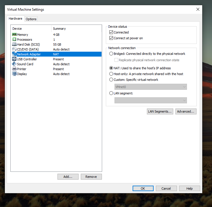

    I just tried NAT networking (see images). Still not working.
