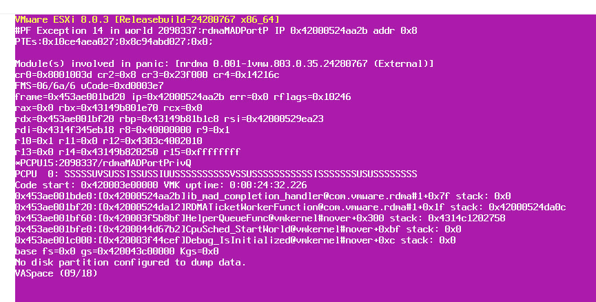

    Thank you. So LACP is gone. Also good. However, there is a serious issue I am facing, already rebuilt the POC cluster twice, because I simply thought I was doing something wrong, but it doesn't seem like it. First time, I had VCSA on vSAN, so that was an error, at least when POCing vSAN. So now only two hosts, out of 3 are participating in vSAN. In the end, the cluster would consist out of 6 hosts.
    The problem is: if I activate RDMA on vSAN, all servers that are participating in vSAN, start PSOD-ing. The only way to get the server which is vCSA (not on vSAN), is to shut down other two, then pull vCSA up, deactivate RDMA, and then boot other two.

    Here is a screenshot of the PSOD:

    I actually found the cause of the issue. The issue also happens on OSA btw, so it's not vSAN-type-dependable.
    The cause was Teaming-Setup. I believe a wrong combination of settings in Teaming of the NICs that do vSAN in combination with RDMA, is what caused the PSODs. I switched back and forth to confirm. I believe it was the setting of two active NICs and virtual port.
    Now have it on physical NIC load and single adapter (but I can also do active/active).
