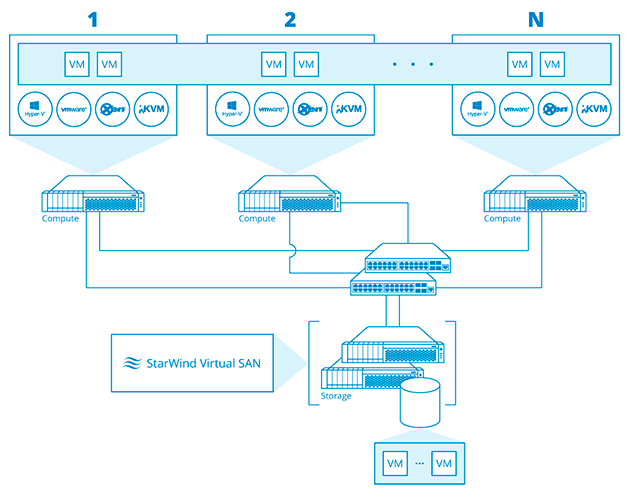

    @Alexander Liuckanov, thanks for mentioning us. Just wanted to confirm VMWare VSAN being a really great product and only a couple of iterations/versions needed for it to become brilliant.
    I am just curious so may ask you about what exactly you did not like about our product? You should definitely give it another try since we have a very great free product https://www.starwindsoftware.com/starwind-virtual-san-free  that allows to turn a couple of old or decommissioned servers into a fault-tolerant SAN or NAS with SMB 3.0 or NFS on top.
    BTW how did you manage to use MSFS ISCSI at all? :-) It is not on VMWare HCL, has half a minute delays on I/O path even under light load and basically barely works at all.
    It’s hard to add something reliable to RPM discussion since we do not have any information about the needed IOPs/workload, still have to confirm that 10k or eve 15k disks will not give you much more speed with only 4 of these.
