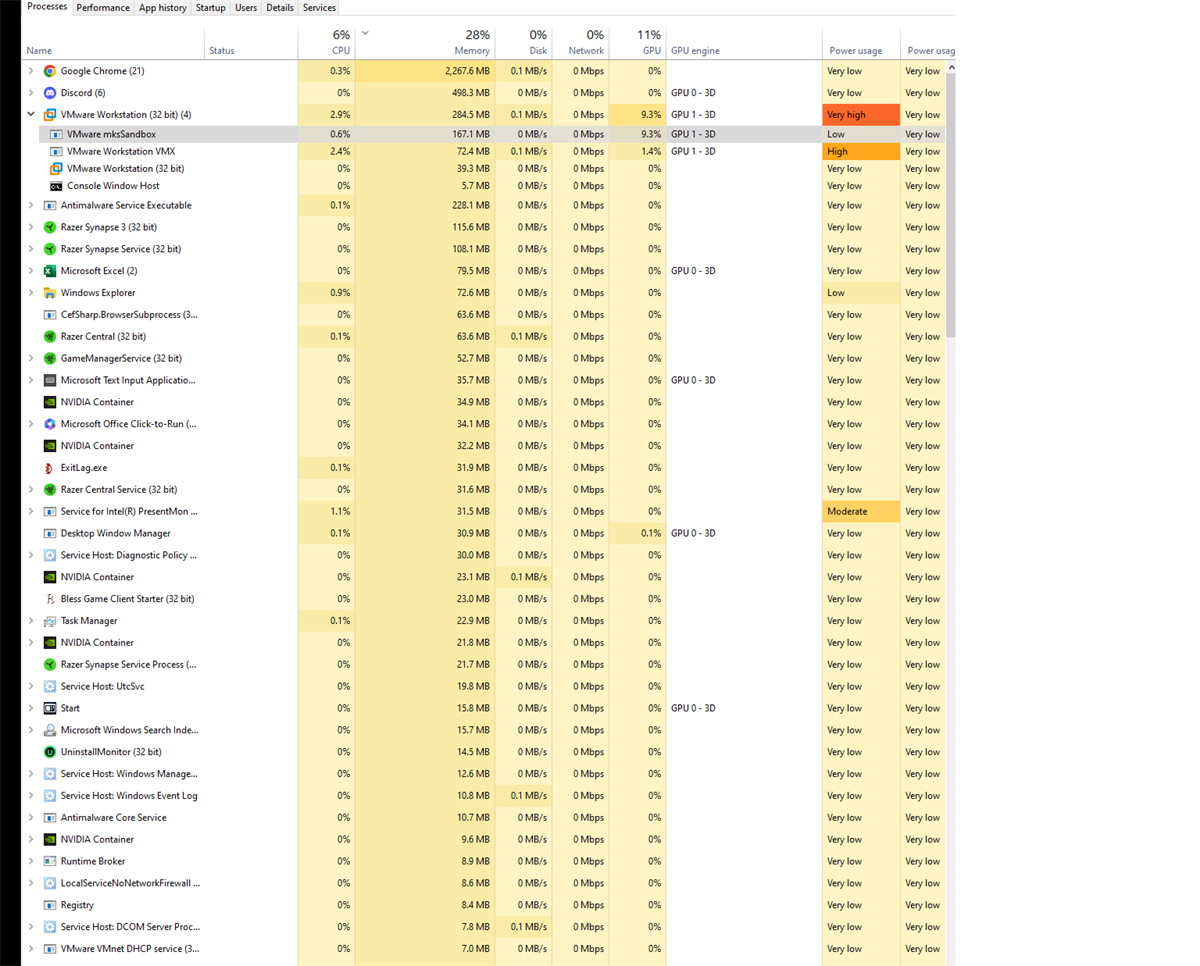

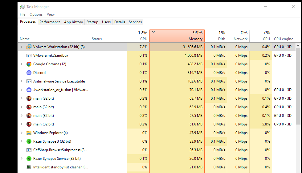

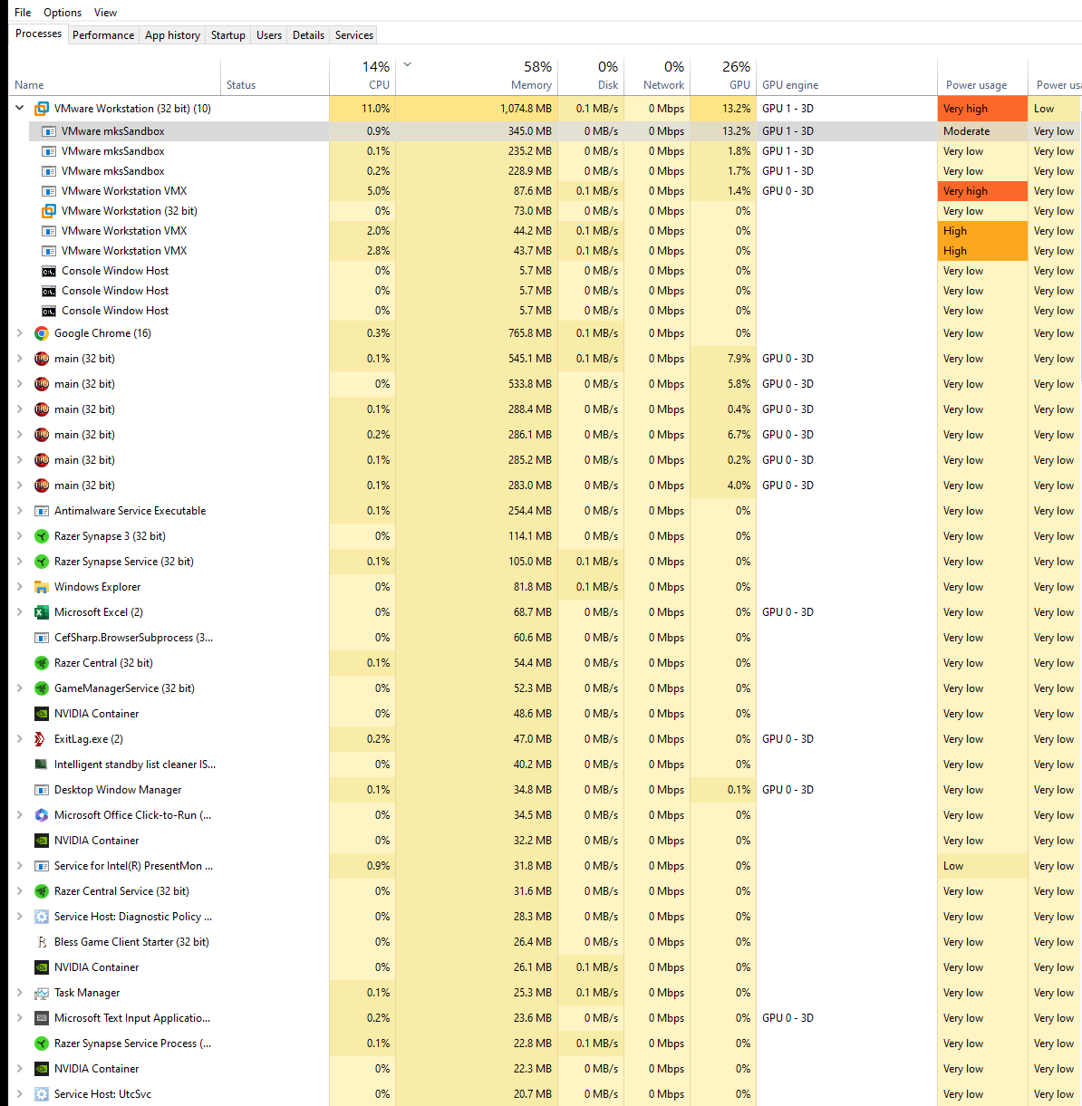

    🔍 The Issue
    Task manager screen shot
    • VMware Workstation consumes more RAM than assigned and does not properly release it.
    • mksSandbox.exe (VMware's graphics process) uses excessive memory (up to 18GB).
    • Standby List was initially a problem, but after fixes, VMware itself was the real culprit.
    • Memory is overcommitted, leading to 100% usage and causing performance issues.
    • Killing mksSandbox.exe frees RAM but also disconnects active games inside VMs.

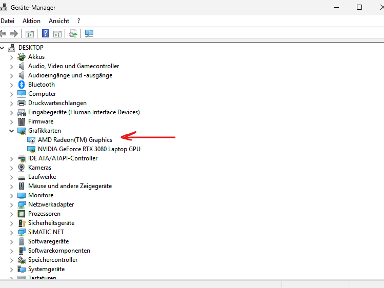

  • 11.  RE: mksSandbox.exe memory bloat
    Posted Apr 19, 2025 12:04 PM
    After spending hours with Windows 11 settings and VMx, I found the solution to the behavior to normal functionality.
    My VMware Workstation Pro 17.6.3 now operates correctly.
    First, I describe the problem: laptops with two graphic cards onboard, like me, cause confusion for the VMware tool. Usually, Windows 11 Pro manages the graphic cards automatically, but after observing that the mks_Sandbox was switching between GPU0 and GPU1 on my computer, I decided to
    DEACTIVATE one card in the Hardware Manager on the host. This resolved my issue.
    Solution: Deactivate the onboard graphic card under the host.
    you don't need to do any kind of changes moor in the vmx config file.
    now under the vmware setting put 3D Acceleration back to AKTIV.
    this is only a hotfix works its works well for my Hardware.
