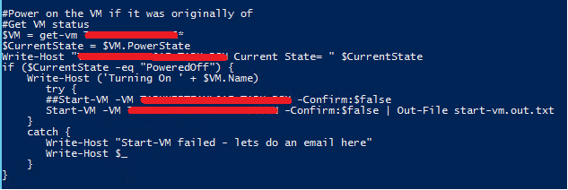

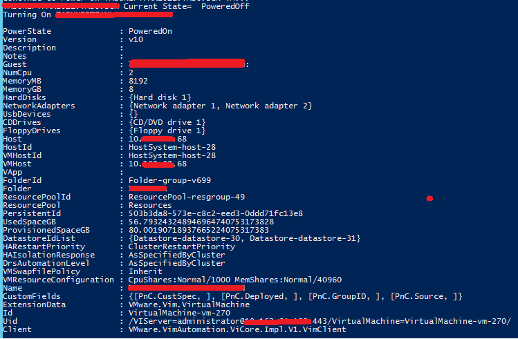

    running powerCLI 5.5
    Do others have this behavior?
    When we do a "Start-VM -VM VNAME -Confirm:$false" ....  we get that long object listing ( in fact some deprecation warnings also )

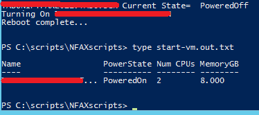

    However when I do "Start-VM -VM VNAME -Confirm:$false | Out-File filename"  or even redirect like this "Start-VM -VM VNAME -Confirm:$false" > filename
    I get very little output.
    It is ODD that redirected output content is different from powershell screen output.
    I did try all other types of redirect like 6>   5> 4> 3> 2>    but ONLY  "1"  i.e. ">"   makes a difference and it becomes a different output.
    Do others see the same behavior?

    NO Redirect source code
    No Redirect output
    With Redirect source code
    With Redirect then listing the “Out-File”

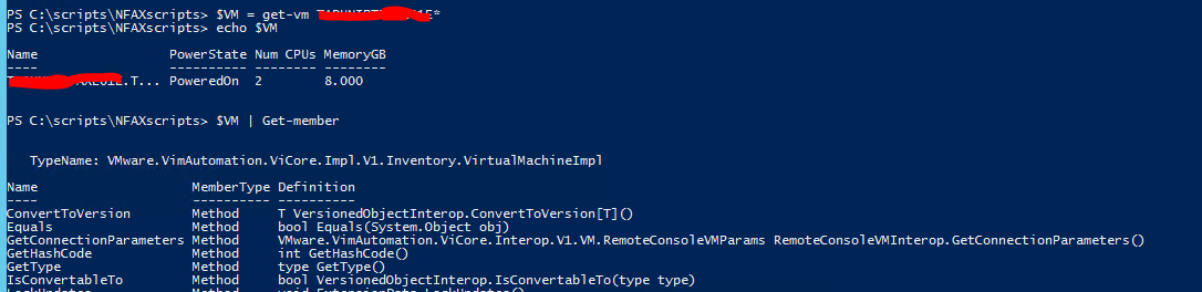

    I would like to see the output from $VM | Get-Member
    And include the 1st line with the TypeName.
    Btw, which PowerCLI version are you using?
    There seem to be some properties in the output that in the current version are not present anymore.
