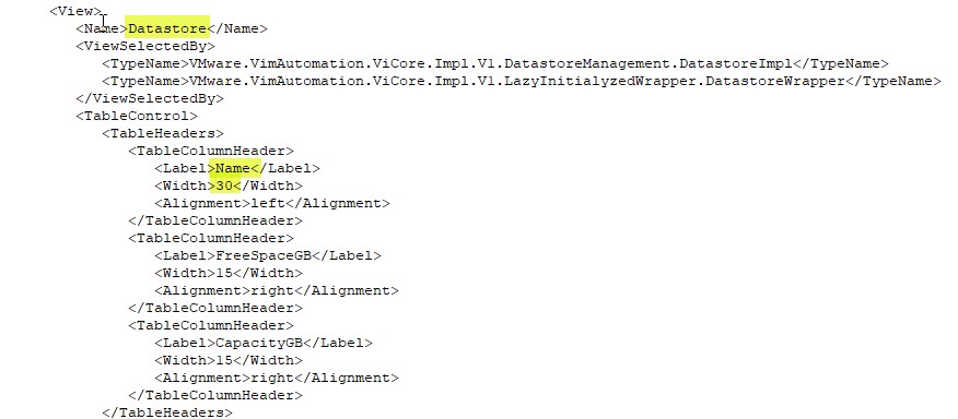

    Get-Cluster yomama | Get-Datastore | Sort-Object -Property FreeSpaceGB -Descending  | Format-Table -HideTableHeaders
    The output is truncated then appended with a "…"
    esx-somebody-made-long-name...
    The actual name is
    esx-somebody-made-long-name-for-the-hell-of-it
    Looks like if more than 29 or 30 characters it does this.
    What's the command to output the full name?

    To get the full name you can use the format operator (-f).
    Like this
    Get-Datastore -Name esx* | Sort-Object -Property FreeSpaceGB -Descending  |
    Select @{N='Name';E={"{0}" -f $_.Name}},FreeSpaceGB,CapacityGB

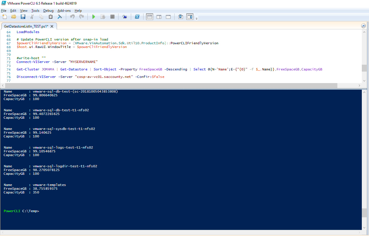

    Here's the weird part.....
    When I run the command below in a plain single command in a PowerCLI window, the output format is correct.
    Get-Cluster cos_wan2 | Get-Datastore | Sort-Object -Property FreeSpaceGB -Descending | Select @{N='Name';E={"{0}" -f $_.Name}},FreeSpaceGB,CapacityGB
    Name                                          FreeSpaceGB      CapacityGB
    vmware-sql-sysdb-test-t1-nfs02                  99.140625             100
    vmware-sql-logs-test-t1-nfs02                 99.10546875             100
    But when I run the command from within a .ps1 file, that's when it gives me the output like below....
    FreeSpaceGB : 99.140625
    CapacityGB  : 100
    FreeSpaceGB : 99.10546875
    CapacityGB  : 100
    Any ideas?

  • 12.  RE: long datastore names truncated after Get-Datastore
    Posted Nov 09, 2018 11:27 PM
    I use whatever the default install of 6.5 created on my desktops shortcut...
    Shortcut points to below....
    C:\Windows\System32\WindowsPowerShell\v1.0\powershell.exe -noe -c ". \"C:\Program Files (x86)\VMware\Infrastructure\PowerCLI\Scripts\Initialize-PowerCLIEnvironment.ps1\" $true"
    Here's the output of the windows...
    Output when executed from a .ps1 file...

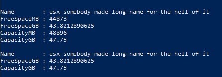

    In a script, when the first output to the console ends up as a list vs a table (the 5 or more properties rule).
    All subsequent output in that script will also be presented in the list format.
    For example when I add a line before the line with the 3 properties
    Get-Datastore -Name esx* | Select Name, FreeSpaceMB, FreespaceGB, CapacityMB, CapacityGB
    Get-Datastore -Name esx* | Sort-Object -Property FreeSpaceGB -Descending | Select @{N = 'Name'; E = {"{0}" -f $_.Name}}, FreeSpaceGB, CapacityGB
    And now execute this as a .ps1 file, I get
    The 1st line is presented as a list due to the 5 properties.
    And from there on, every output is presented as a list (even when less than 5 properties).

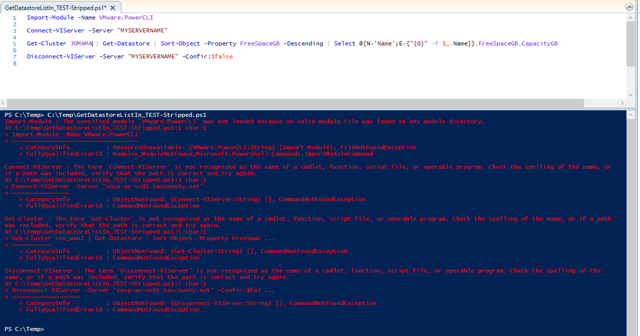

    Just open the regular PowerShell ISE, try this:
    Import-Module -Name VMware.PowerCLI
    Connect-VIServer -Server "MYSERVERNAME"
    Get-Cluster JOMAMA | Get-Datastore | Sort-Object -Property FreeSpaceGB -Descending | Select @{N='Name';E={"{0}" -f $_.Name}},FreeSpaceGB,CapacityGB
    At least it will rule out a) whether it's any of the VMware stuff overlayed onto ISE, and b) anything in your code.  It formats correctly in my PS ISE, but I'm not running any of the VMware stuff overlayed.
  • 17.  RE: long datastore names truncated after Get-Datastore
    Posted Nov 10, 2018 12:08 AM
    I had high hopes for this one but I got this....
  • 18.  RE: long datastore names truncated after Get-Datastore
    Posted Nov 10, 2018 12:11 AM
    There is no VMware.PowerCLI module in 6.5 R1, that only appeared in 6.5.1 (which is not the same as 6.5 R1)

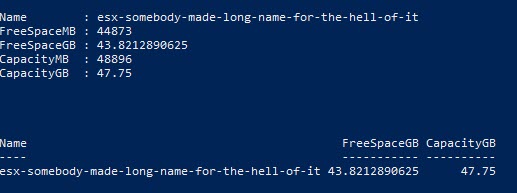

    Btw, you can reset that default behaviour by using the Out-Default cmdlet.
    For example
    Get-Datastore -Name esx* | Select Name, FreeSpaceMB, FreespaceGB, CapacityMB, CapacityGB | Out-Default
    will produce

    I modified my ps1 scripts and ran it in my .Net VB Windows Forms app and it worked like a charm!
    EDIT:
    I was wrong, the FreeSpaceGB and CapacityGB did not come over.
    Marked thread unanswered.

    The real explanation is that the PowerCLI cmdlets use Extended Data Types to display properties from PowerCLI objects.
    These data types are defined in the .ps1xml files that live in the PowerCLI modules.
    In this case the Name property of a Datastore object is limited to 30 characters.
    And 30 minus the three dots makes 27.
    This is the part of the VMware.VimAutomation.Format.ps1xml file where that is defined.
    In fact this was one of the subjects we handled in out VMworld session VIN1992BU (US) and VIN1992BE (Europe).
