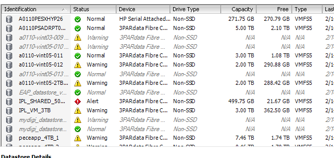

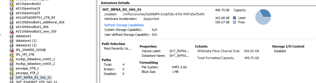

  • 9.  RE: List VMs in datastore that is not in inventory
    Posted Oct 29, 2015 07:31 AM

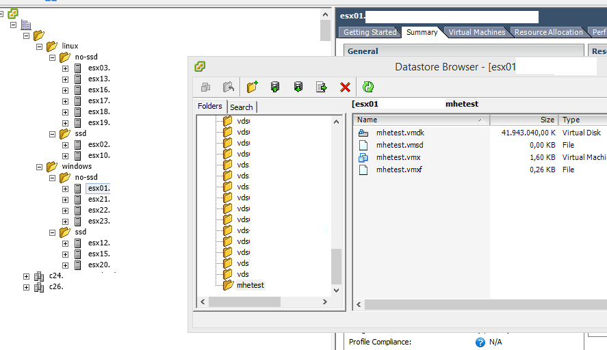

    Thanks Luc, but I already tried that, still doesn't pick up the orphaned vmdk file.
    By singlehosts, I mean hosts that is not joined to a cluster, but are added to a VCenter.
    Heres the environment, and a test VM on the datastore that is not in inventory.
  • 10.  RE: List VMs in datastore that is not in inventory
    Posted Oct 29, 2015 07:40 AM
    Can you check what the DisplayName in the VMX file says ?
    It could be that these files are attached to a VM that is registered under another DisplayName than mhetest.
  • 11.  RE: List VMs in datastore that is not in inventory
    Posted Oct 29, 2015 07:45 AM
    That does not seem to be the issue.
    displayName = "mhetest"
  • 12.  RE: List VMs in datastore that is not in inventory

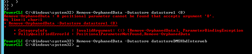

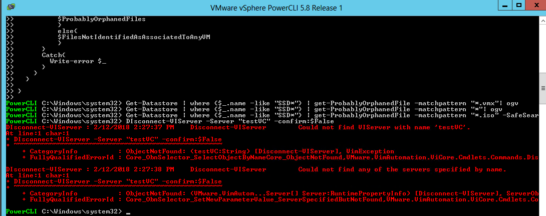

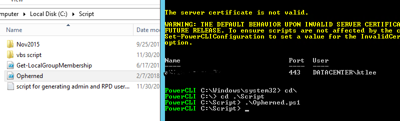

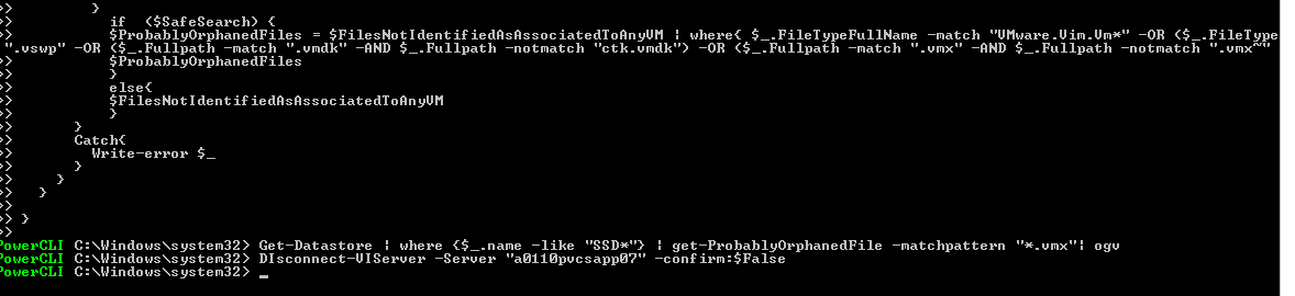

  • 27.  RE: List VMs in datastore that is not in inventory
    Posted Feb 07, 2018 02:50 AM
    Hi LucD
    i have save the file in PS and when i call it nothing happen?
    what went wrong?
    when i copy the file manually, here is the error
    and another try
    help help
  • 28.  RE: List VMs in datastore that is not in inventory
    Posted Feb 07, 2018 05:40 AM
    That is not what I said, you have to add that line to the .ps1 file at the end, not enter it at the prompt

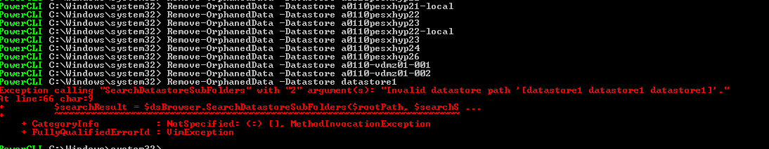

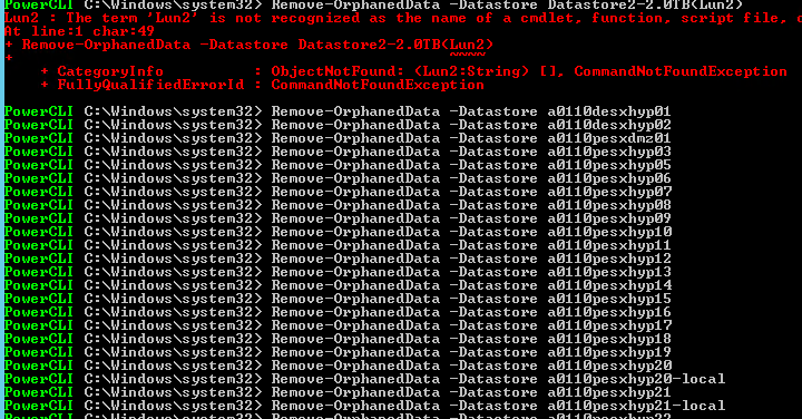

    1)  Name not correct ?
    2) i try manually copy script and pass into CLI , and then run the function call manually by enter datastore one by one. all seem pass?
    also i notice some command just take mili second (superfast,feel like not working)
    3) Data store not work in here? because not cluster?
    sorry to take time understand the script
  • 30.  RE: List VMs in datastore that is not in inventory
    Posted Feb 07, 2018 06:36 AM
    If you have special characters in the datastorename, enclose the name in single quotes.

    Posted Feb 07, 2018 07:01 AM
    2. If there are no, or hardly any VMs on that datastore, the function might return quite quickly
    But are these perhaps NFS datastores?
    The default function only looks at VMFS datastores
    3. Shouldn't make a difference
    Not sure what you mean with "...to run as the datastore are in use and..."
    The idea is that this function runs against datastores that are used to store VMs

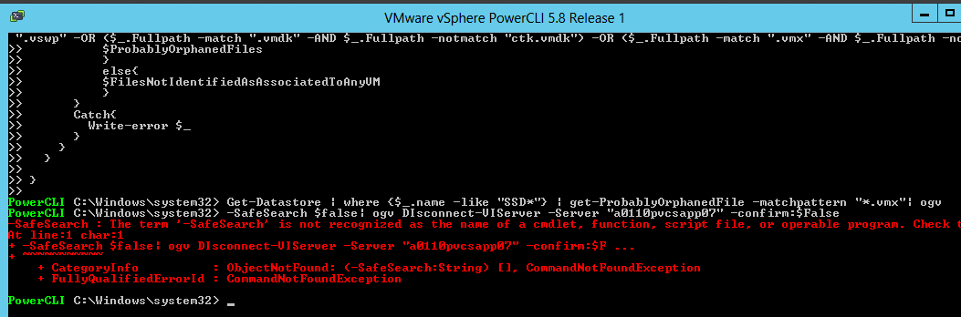

    and copy the last script  - get-ProbablyOrphanedFile and past it to CLI.
    then copy the script as following , any idea why the result was not show?
  • 36.  RE: List VMs in datastore that is not in inventory
    Posted Feb 12, 2018 07:01 AM

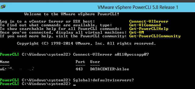

    Are you sure you where connected?
    After the Connect-VIServer did you check by displaying the contents of $global:defaultviservers?

    Hi LucD
    not sure if this are correct ?
  • 38.  RE: List VMs in datastore that is not in inventory
    Posted Feb 12, 2018 08:25 AM
    The Connect-VIServer seems to be correct.
    Not sure why you have the '?' after $global:defaultviservers
  • 39.  RE: List VMs in datastore that is not in inventory
    Posted Feb 12, 2018 09:19 AM
    Hi LucD
    i thought you ask to verify by " displaying the contents of $global:defaultviservers? "
  • 40.  RE: List VMs in datastore that is not in inventory
    Posted Feb 12, 2018 09:26 AM
    That was the question mark for my question, no you shouldn't type the question mark, just $global:defaultviservers
  • 41.  RE: List VMs in datastore that is not in inventory
    Posted Feb 12, 2018 09:55 AM
  • 42.  RE: List VMs in datastore that is not in inventory
    Posted Feb 12, 2018 12:14 PM
    Ok, going back to the error, you seem to be doing a Disconnect-VIServer from a server TestVC, which is not the name of your vCenter.
    It looks as if the code you copied contains that TestVC somewhere in there.
    Replace that with your own vCenter name.
  • 43.  RE: List VMs in datastore that is not in inventory
    Posted Feb 13, 2018 02:45 AM
    Hi LucD
    this is the screen shot , nothing came out ?
  • 44.  RE: List VMs in datastore that is not in inventory
    Posted Feb 13, 2018 05:57 AM
    Then you probably have no orphaned VMs

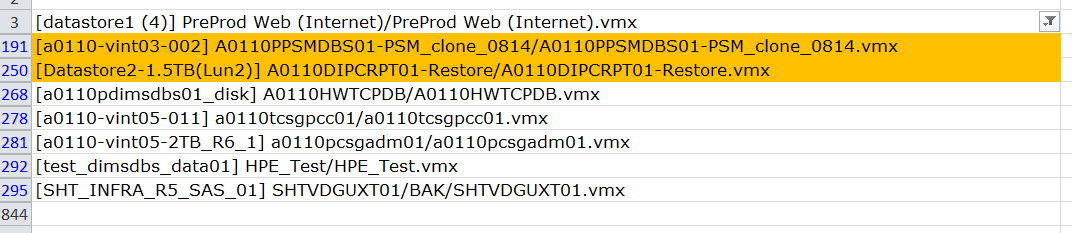

    i seem, but when i use your script it show some of this file ( i filtered by vmx)
    any different ?? just curios
    without filters is as per attachment  (sheet 1 is using your script, sheet 2 is using RV tools scan).

    Hi LucD,
    I updated with attached the result in excel sheet
    (Apologize, i attached the correct document here again, left size column is with RV tools, right side is with your script)

    With the 2nd script you are using a Where-clause to only look at datastores whose name starts with SSD.
    Do you actually have such datastores?
    Try leaving out the Where-clause, and only select DS1, like
    Get-Datastore -Name DS1 | Get-ProbablyOrphanedFile -matchpattern “*.vmx”|
    Out-GridView
  • 51.  RE: List VMs in datastore that is not in inventory
    Posted Feb 13, 2018 08:36 AM
    Hi LucD
    here is my datastore summary
    and this is what i run just now
  • 52.  RE: List VMs in datastore that is not in inventory
    Posted Feb 13, 2018 10:52 AM
    You have to dot-source that Get-ProbablyOrphanedFile function before calling it.
    Otherwise you get exactly that error.
    Store the code of the function in a .ps1 file, then dot-source the .ps1 file from the prompt (. .\thefile.ps1, and yes, there is a blank between the two dots)
    After that you should be able to call the function from the prompt.
    From your datastore list, it looks like you have no datastores whose name starts with SSD.
    So that explains why nothing comes out of the call you made earlier.

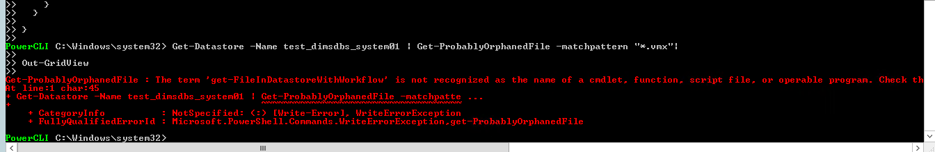

  • 53.  RE: List VMs in datastore that is not in inventory
    Posted Feb 14, 2018 03:55 AM
    Sorry LucD
    not sure which area went wrong ( I have test blank between two dot)
  • 54.  RE: List VMs in datastore that is not in inventory
    Posted Feb 14, 2018 05:31 AM
    The function Get-FileInDatastireWithWorkflow is missing.
  • 55.  RE: List VMs in datastore that is not in inventory
    Posted Feb 14, 2018 05:38 AM
    Hi LucD
    how to fix this? where edit ?
    help help
  • 56.  RE: List VMs in datastore that is not in inventory
    Posted Feb 14, 2018 05:47 AM
    You'll find that missing function at the same location where you found the other function.
    See Find orphaned vmdk files via workflow
