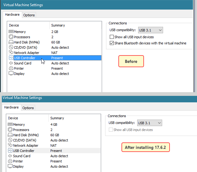

    Whatever I tired Workstation did not show removable drives in the drop down menu.

    5. "Removable drives" item still doesn't show up.

    Seems okay, except removable drives-item in the drop down menu isn't listed anymore.
    Checked screenshots of the previous version vs. what's now.
    show all USB input devices is greyed out.
    Also the status of VMware tools remains "Reinstall VMware Tools" - even after doing it twice.
