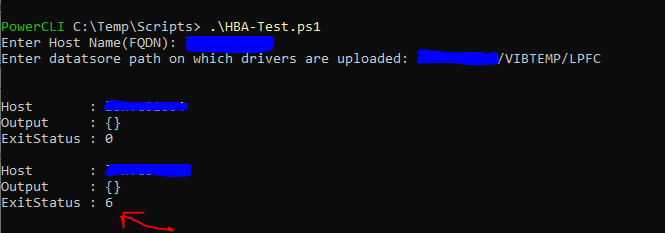

    I am getting the below out put with ExitStatus as 6:

  • 6.  RE: Install .vmexe file using POSH-SSH
    Posted Jul 20, 2020 08:54 AM
    Did you try with the -s parameter?
  • 7.  RE: Install .vmexe file using POSH-SSH
    Posted Jul 20, 2020 09:06 AM
    Yes but same ExitStatus as 6.

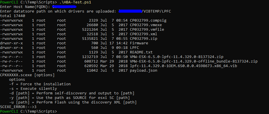

  • 17.  RE: Install .vmexe file using POSH-SSH
    Posted Jul 21, 2020 08:11 AM
    I am getting the below error after running this code:
  • 18.  RE: Install .vmexe file using POSH-SSH
    Posted Jul 21, 2020 08:27 AM
    Ok, looks like we are getting somewhere.
    Can you replace these lines
    $result = Invoke-SSHCommand -SSHSession $session -Command ($ExecutionContext.InvokeCommand.ExpandString($code)) -Verbose
    $result | Format-Custom
    with these
    $result.Output
    and run it again?

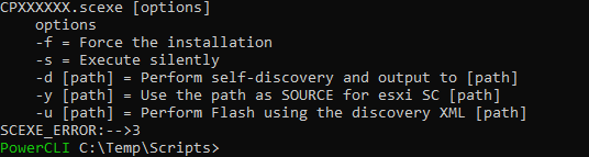

  • 19.  RE: Install .vmexe file using POSH-SSH
    Posted Jul 21, 2020 08:49 AM
    This time getting the below error:
  • 20.  RE: Install .vmexe file using POSH-SSH
    Posted Jul 21, 2020 08:56 AM
    Let me try to install it on another host with this updated code. I will get back to with the result shortly.
  • 21.  RE: Install .vmexe file using POSH-SSH
    Posted Jul 21, 2020 09:31 AM
    It looks as if error code 3 indicates a 'downgrade'.
    Apparently the 'force' flag is required.
    Try adding the -s -f parameters on the call to the vmexe.

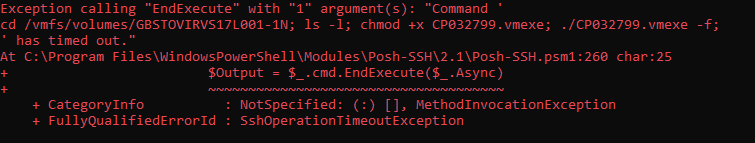

    At last its executed after putting semi colon at the end as as shown below:
    $code = @'
    cd $dspath; ls -l; chmod +x CP032799.vmexe; ./CP032799.vmexe -f;
    However getting the below after the installation. How to get rid of it.
  • 26.  RE: Install .vmexe file using POSH-SSH
    Posted Jul 21, 2020 11:10 AM
    That looks to be a timeout happening.
    The Invoke-SSHCommand cmdlet has a Timeout parameter, you could try using that.
    I have no clue how long this vmexe is supposed to run.
    How long did it run when you executed it from an interactive session?
