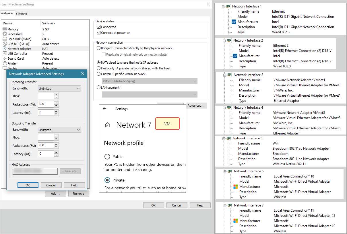

    The Ookla speedtest shows that the up and download speed within Workstation Pro (17.6.1) is less half the speed of the host, 380Mbps down and 465Mbps up. I have a 1Gbps subscription. In Network Adapter settings NAT is selected. I believe this is by default. When checking Network adapter properties I see that VM is using a different settings host vs VM.
    I used a tool that lists all details about network on the host. It shows 7 Network Interfaces (?) and the VM is connected to the 7th (WiFi as it looks).
    I don't know, maybe I should select "Bridged"?
    Thanks!

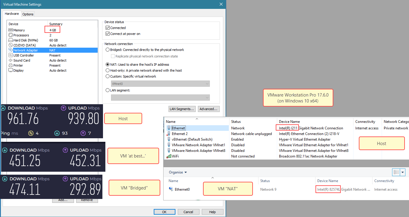

    I increased the RAM from the 'recommended' 2GB to 4GB and changed the network to NAT.
    (Tried other settings, like 'bridged' as well)
    Regretfully it doesn't make a big difference. At best, the Internet speed is half of that of the host.
    What I do note is the VMware Network Adapter (Host: Intel i211 vs VM: Intel 82574L)
    Vainly tried to figure out the VM-Internet speeds - could not find any screenshots on that.
    Have no idea whether this is normal or not.
    What are your Internet speeds (host vs VM)?

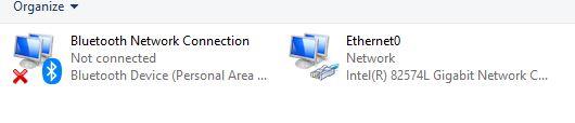

    You still have many networks there, also vEthernet which is default to something. I have attached a picture of what is the standard-Microsoft-related-Windows11Pro -situation. Your computer seems like something cloned from a physical computer. "Not connected", is not the same as "Disabled" - it is still trying to connect. "Hyper-V Ethernet Adapter" - feels like usoft-virus to me on a VM - just kidding.

      |   view attached
    Note that VM has 1 network connection only, same as yours. Ethernet0 (82574L Gigabit). I disabled vEthernet. Launched Workstation, did the speedtest test. Same speeds.
    What are your speeds then? Host vs VM.
    FWIW  - as for vEthernet - below details - don't know what it is - have not installed it myself.
