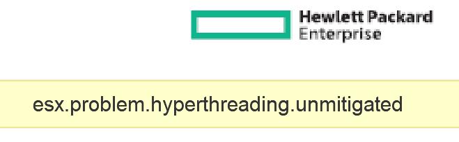

    I have updated HP Gen8 server to ESXi 6.5 U2 using bios method.
    I got this message. How to resolve it?
  • 2.  Re: HP server update w/ custom image
    Posted Jun 15, 2019 01:11 PM
    It's basically a warning regarding another Intel CPU issue.
    You can either do the necessary steps to resolve the issue, or suppress the warning (see e.g. https://kb.vmware.com/s/article/57374​). This actually depends on your security requirements.

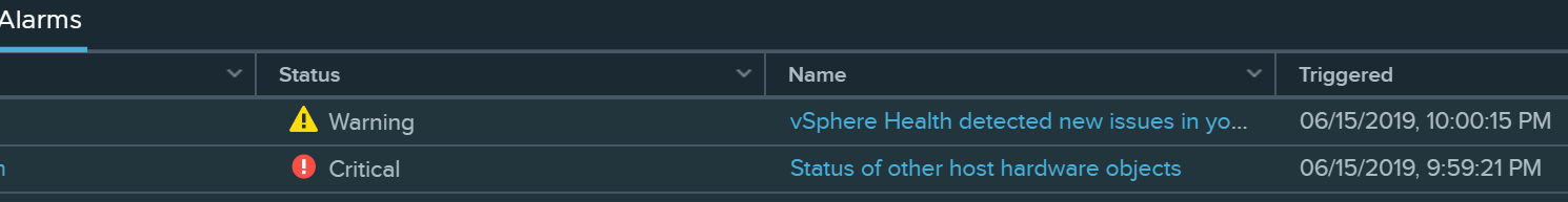

    I have updated to VMware-VCSA-all-6.7.0-13643870.iso and so far looks good.
    Except I get:
    How to properly delete old vCenter?

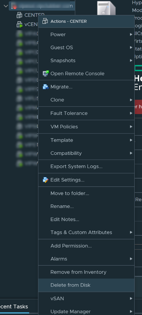

    I tried delete from disk option but for some reason I still see it in datastore browser.

    vCenter has a new "vSphere Health" alarm definition, which will will trigger if issues are detected. However, these issues are determined by checking metadata through VMware's Customer Experience Improvement Program (CEIP). If you opted out, you will have to disable the alarm definition to get rid of the warning.
    I can't unfortunately comment on the second issue without taking a look at the host's hardware.

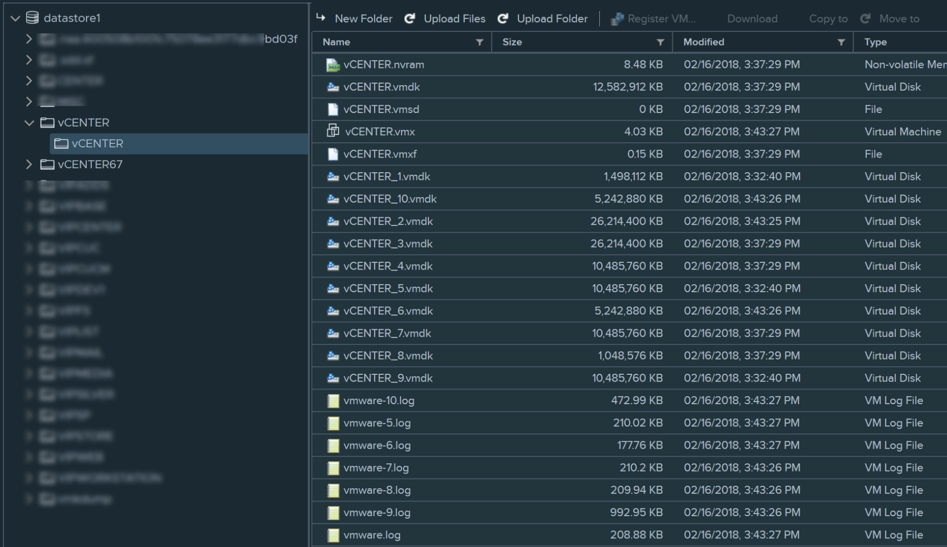

    I deleted old vCenter with delete from disk option. However when I go to datastore the entire folder is there but should have been gone.
    Any idea? Disregard what I am deleting in first image its just to show option being used.
    If that is the case then how to delete old vCenter alternative way?

    The image shows old files (February 2018) in a sub-directory, so it looks like someone copied the VM at some point in time!?
    Delete from disk does only delete the VM related files. If you don't need the files in the sub-directory anymore, you may delete them directly from the datastore. As an alternative, you could register the VM from the sub-directory, and use "Delete from disk". In that case, you may need to manually delete the VM's main directory, which should then be empty.
