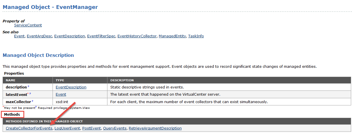

    In this case you want to create an EventCollector (to retrieve events from the vCenter).
    We start with the EventManager. (how you know to start with that one is based on the SDK Programming Guide, experience, other threads, blog posts...

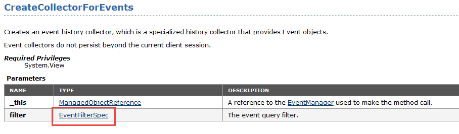

    In there you see that there is a method named CreateCollectorForEvents.
    Click the link and go to the method documentation.
    We see the method requires a parameter of the type EventFilterSpec.
    Following the link, we see which properties can/need to be filled in.
