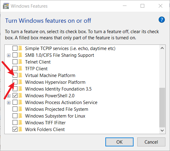

    First go to the search icon for windows and find the Turn Windows Features on and off.
    Then go disable Virtual Machine Platform and Windows Hypervisor Platform options.

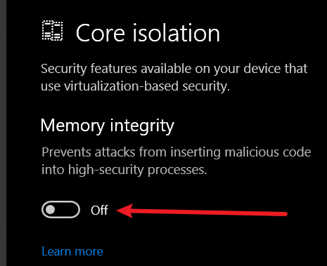

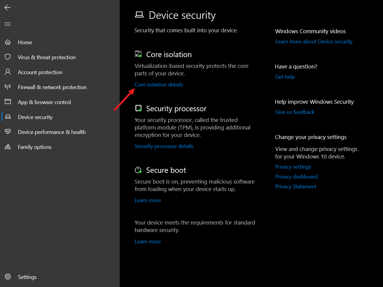

    Second go to Device Secutity.
    Make sure that the Core isolation option is Off.
    Good luck!
