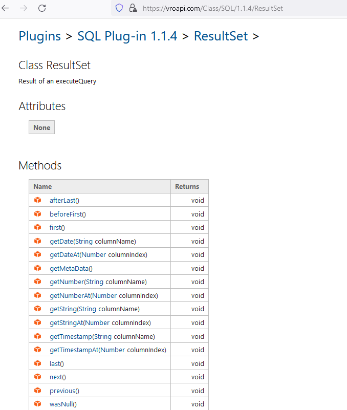

    Looking at the code from vcoportal again
    The section in red details the handling of the ResultSet which is returned by the execution of the call to the procedure. You can see the documentation for ResultSet here (from vroapi.com)
    Anyway, since your procedure returns ONE value, you can access it by doing this
    var resultSet = callStm.executeQuery();
    var procedureReturnValue = null;
    if(rs.next()) // if the result set has content
        procedureReturnValue = rs.getString(1); // get the result at position 1 in the first row
    rs.close();
    callStm.close();
    Note, you should use all of the try/catch logic as depicted in the example, just fit your result set handling inside where the comment says "Process the results...."
    The other posted example will also work so you have your choice
