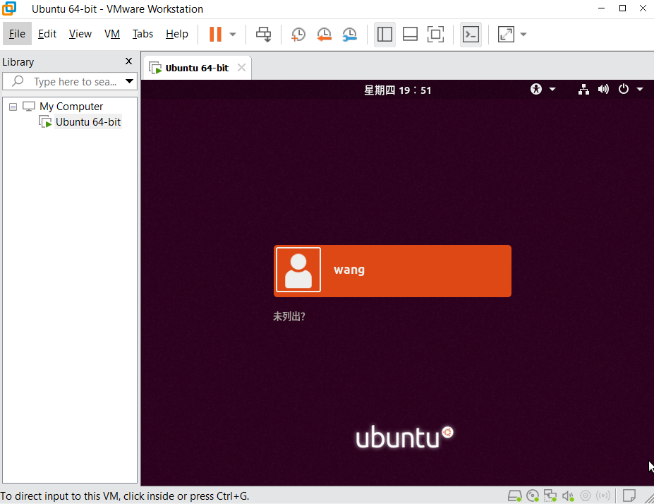

    • I have one laptop which has one Nvidia RTX A2000 Laptop GPU,  & DirectX 12 & OS is Window 10. Please refer to picture 1

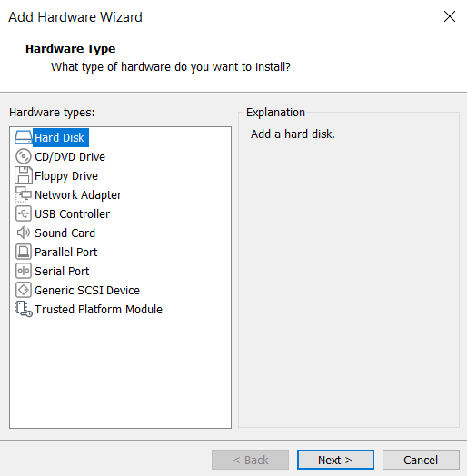

    • Vmware workstation Pro 17.6.2 was installed, inside was Ubuntu, please refer to picture 2

    • I tried to add PCI device in vmware setting, but no this option, please refer to picture 4.

    Picture 1: Nvidia Rtx A2000
    Picture 2: vmware with Ubuntu

    picture 4:

    What you're looking for is PCI passthrough, but VMWare Workstation does not support that. And if it would support that the GPU would need to support device virtualization, otherwise your host would be left without a GPU to display, unless your laptop CPU has integrated graphics as well.
