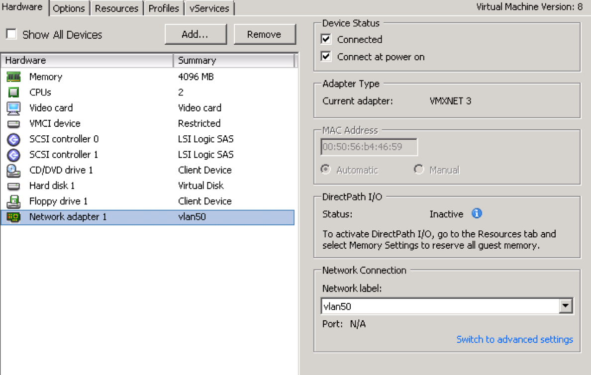

  • 3.  RE: How to change VM NIC to VMXNET3 without replacing MAC Address?
    Posted Jun 30, 2014 08:09 AM
    I've used this in the past to change from E1000 to VMXNET3 without changing MACs:
    Get-VM "vmname" | get-networkAdapter | Where { $_.Type -eq "E1000"} | set-NetworkAdapter -Type "vmxnet3" -NetworkName "porggroupname",.

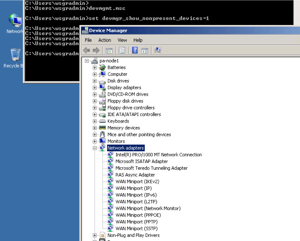

    I was able to run that same command on a 2008 guest and in vmware it did get changed to vmxnet3
    but windows woud not recognize any difference and still shows e1000
    do i need to remove the nic from inside windows?

  • 6.  RE: How to change VM NIC to VMXNET3 without replacing MAC Address?
    Posted Jul 21, 2015 04:42 PM
    Could it be that you have one or more hidden devices ?
    Inside the Windows OS, do the following
    • start a CMD prompt
    • type set devmgr_show_nonpresent_devices=1
    • start devmgmt.msc from inside the CMD prompt
    • in the Device Manager under View select Hidden Devices
    • look under the Network Adapters branch (you can uninstall such a device from here)
  • 7.  RE: How to change VM NIC to VMXNET3 without replacing MAC Address?
    Posted Jul 21, 2015 05:23 PM
    lucd
    I dont see it under devices and I did show the nonpresent devices
    The vm used to be on e1000 and I already changed the nic to vmxnet3 with
    get-vm xxx | get-networkadapter | set-networkadapter -type vmxnet3 -confirm:$false

  • 13.  RE: How to change VM NIC to VMXNET3 without replacing MAC Address?
    Posted Mar 09, 2016 10:42 AM
    You can change NIC type to VMXNET3 via PowerCLI without replacing MAC address:
    List VM: SRV1, NIC type:
    Get-VM SRV1| get-networkadapter
    Change VM: SRV1, NIC type to VMXNET3:
    get-vm SRV1 | Get-NetworkAdapter | set-networkadapter -type vmxnet3 -confirm:$false
    This procedure preserves the original MAC address, but NIC adapter changes.
    Here are more detailed info: http://www.sysadmit.com/2016/03/vmware-cambiar-tipo-de-nic-sin-cambiar-la-MAC.html
    If the operating system is Windows, the old NIC hasn’t actually been removed from Windows, it's just hidden.
    You must remove it, here is the procedure:
    http://www.sysadmit.com/2015/09/windows-eliminar-dispositivos-ocultos.html
