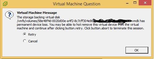

    While testing this setup for resiliency against hardware failures, we wanted to know what happens in the event of a total loss of a single storage unit. To this end, we accessed the management console of StorageA and unpresented DatastoreA from both clusters, meaning both clusters suddenly lost connectivity with DatastoreA, creating a PDL (permanent device loss) situation.
    What happens next is that both RAC1 and RAC2 completely freeze, and VMware generates a dialog box for each VM, like this:
    After reading up on this, it seems to me that it is standard ESXi behaviour to freeze a virtual machine as soon as it tries to write to a VMDK file that is no longer available. Because both RAC1 and RAC2 are connected and try to write to a VMDK file that is no longer there, both VMs are automatically suspended by ESXi.
    This is, of course, exactly what we DO NOT want to happen in a HA solution like Oracle RAC. The way it is now, a single storage failure or even a WAN failure would result in total loss of the database instance, even though one copy of all the database storage is still online. What am I missing here? What is the correct way to configure Oracle RAC on the VMware platform???
