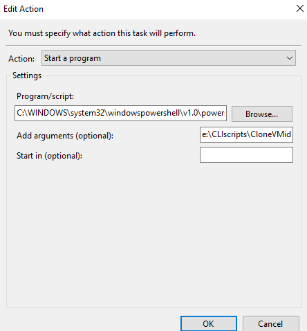

    Where is the -NonInteractive parameter added ?
    In side the .ps1 script or as a parameter in the task job within scheduler (below screen)?
  • 8.  RE: How do I exit PowerCLI on an error in a script running in Windows Scheduler
    Posted Sep 11, 2023 10:19 PM
    I added -NonInteractve below.  When I right click the task and select run, the Powershell screen flashes up and now I see a 0x1 in the Last Run Results in Task Scheduler
