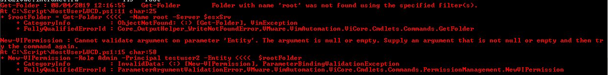

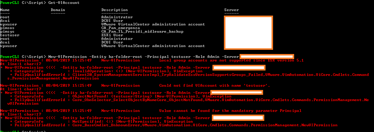

    I have this error
    I tried using the ha-folder-root as root folder  but i got this instead
    Checked with Get-ViAccount and i get
    What am i missing?

  • 6.  RE: Host user add, custom UID&GID and role assignment
    Posted Apr 08, 2019 11:00 AM
    When you are connected to an ESXi node, you need to give the permission on the 'root' folder.
    But they changed the name of the 'root' folder in recent ESXi versions.
    It could be 'ha-root-folder' instead of 'root'.
    Connect to an ESXi node and do a Get-Folder, you should see what the name is in the ESXi version you are using.
  • 7.  RE: Host user add, custom UID&GID and role assignment
    Posted Apr 08, 2019 01:31 PM
    I already tried it, maybe you missed in the other post, this single command's output.
    I think i am missing some stupid thing, i am sorry but my powercli expertise is quite low
  • 8.  RE: Host user add, custom UID&GID and role assignment
    Posted Apr 08, 2019 01:32 PM
    Can you show the output of the Get-Folder cmdlet, not the Get-VIAccount?

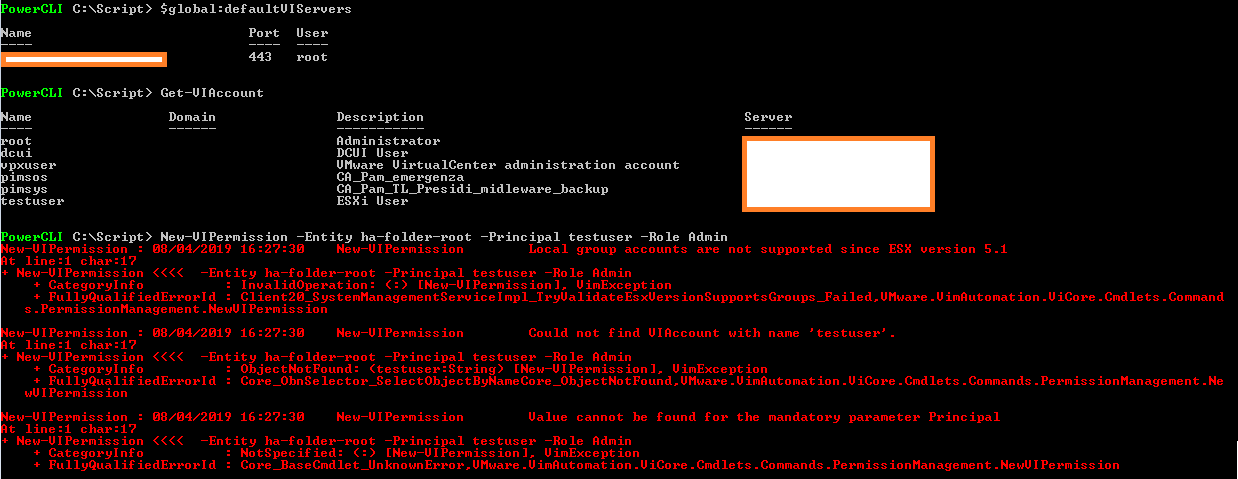

  • 9.  RE: Host user add, custom UID&GID and role assignment
    Posted Apr 08, 2019 02:01 PM
    Sure
  • 10.  RE: Host user add, custom UID&GID and role assignment
    Best Answer
    Posted Apr 08, 2019 02:08 PM
    As I tried to explain before, the name of the 'root' folder has changed in the different ESXi versions.
    In your case you will need to use ha-root-folder instead of root.
    The script should be
    $esxSrv = Connect-VIServer -Server $esxName -User root -Password $pswd
    $user = New-VMHostAccount -Server $esxSrv -Id testuser1 -Password VMware1! -UserAccount -GrantShellAccess
    $rootFolder = Get-Folder -Name ha-folder-root -Server $esxSrv
    $role = Get-VIRole -Name Admin -Server $esxSrv
    New-VIPermission -Entity $rootFolder -Principal $user -Role $role
    Disconnect-VIServer -Server $esxSrv -Confirm:$false
  • 11.  RE: Host user add, custom UID&GID and role assignment
    Posted Apr 08, 2019 02:12 PM
    Sorry LucD, but is exactly what i did if you look at the screens :smileyhappy:
  • 12.  RE: Host user add, custom UID&GID and role assignment
    Posted Apr 08, 2019 02:18 PM
    It looks like you are connected to multiple servers.
    Check what is in $global:defaultVIServers, and make sure there are no connections open before you run the script.

  • 14.  RE: Host user add, custom UID&GID and role assignment
    Posted Apr 08, 2019 02:42 PM
    No, you are not doing what I provided.
    You have to get the folder in a variable and the role as well.
