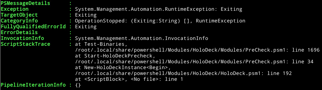

    Posted 27 days ago

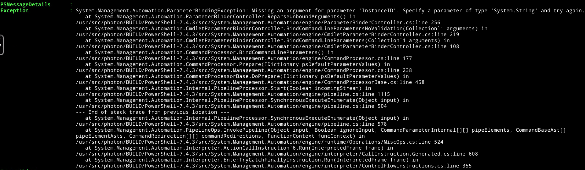

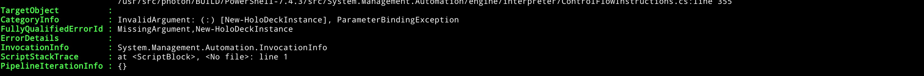

    Sorry I was out of office but here it is:
    $error | select * gives this

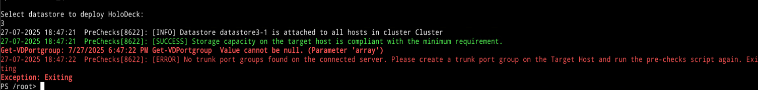

    Removed host 2 > then continues correctly but now I got stuck on the No Trunk Port Groups.

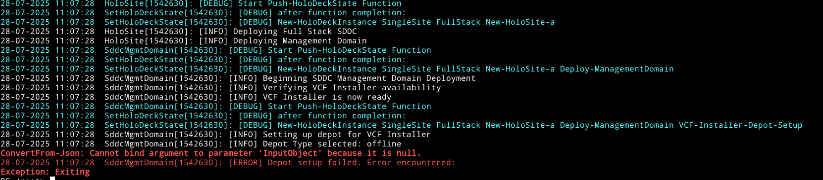

    5th time > pushed the new configuration to the esxi host directly (again) but failed on serveral items (random) but after set -loglevel debug  and pushed it 4 or 5 times the installation suddenly continues.. but stil with the paravirtual adapter issue. Now setup the basic managementonly config.
    Issue with vCenter also solved: https://knowledge.broadcom.com/external/article/377968/vcenter-server-upgrade-failed-due-to-obs.html

  • 8.  RE: Holodeck vcf 9 - Cannot select datastore
    Broadcom Employee
    Posted 21 days ago
    Hi Hendrik,
    The error in the screenshot you posted is because the powershell session was first connected to a vCenter and then you tried using a host as the target. To avoid this, just exit the powershell session and start from scratch with just the host as the target. Note the host needs to be stand-alone host and not a host managed by vCenter.

    Removed host 2 > then continues correctly but now I got stuck on the No Trunk Port Groups. - Do you have a trunk port group on host 1? Is it a vSS or vDS port group? Is it configured to be trunk? The port group needs to be trunk and available on all the hosts within the cluster.

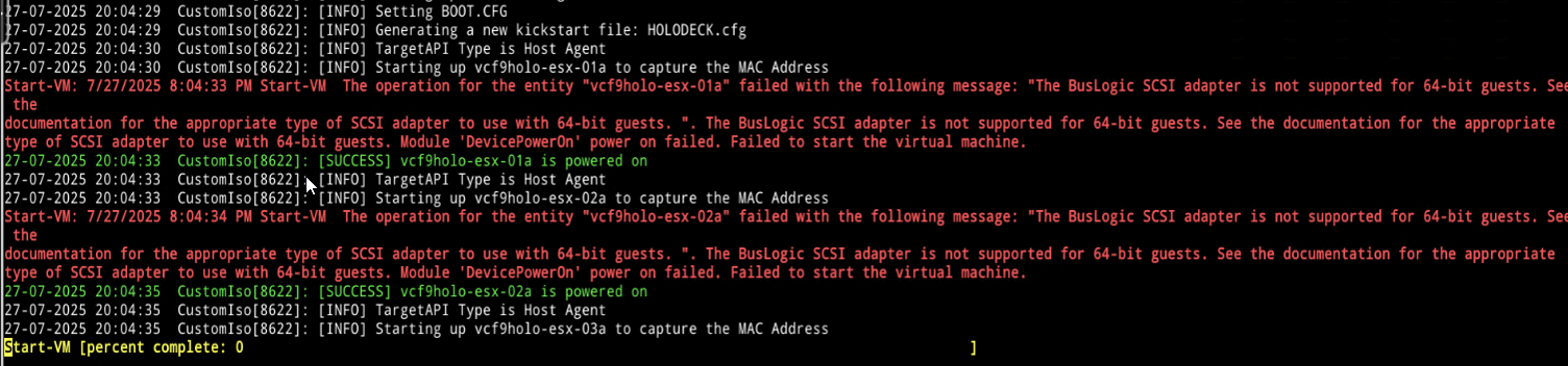

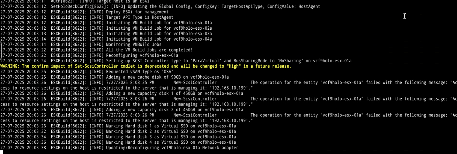

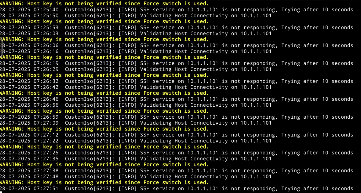

    Detail about the paravirtualized is shown below:
    It failed to change it because the (targethost managedby )vCenter (192.168.10.199) seems to prohibit this.
    Regarding the switches > yes I am using VSS > but on all host does not the trick because the VSS cannot have up-links > see documentation for preparations. VDS gives the same error > it just skips the question because it can't find any switch.
    But after a 5th try it could..
    What does a configuration of the VSS or PG makes it a TRUNK... so it should be detected by Holodeck?? > 4095 ?

    Ok so I am able to go further in the process. This is what I did and now I'm stuck again :)
    I have a vc with 2 hosts. I deployed the holorouter in vCenter on a distributed switch vlan.
    I detached a host, staerted the terminal and powershell and I get to select a san datastore, not every datastore but I managed to select one and it's good enough for me. It deployed all the ESX vms but now I get this:
    The holorouter is connected to a vlan that has connection towards the network and 2 ports that I created, the holo-pg A and B one like instructed. I can see that the ESX servers are connected to the holo-pg-a but there is still something wrong I guess

    Hi Lie_DW,
    When I had this messages the nested hosted were not booting because of the controller was not a paravirtualized adapter.
    The server does not boot anyway.
    This only happens when a vcenter/esxi (v8) hosts are involved in the hosted platform I was using.
    The vcenter seems to be getting in the way to change the adapter because it is not allowed by the vcenter when you used the ESXi host in the create new holodeck command in pwsh.
    When the start failed I had to change the adapter manually an boot the server to complete the installation of the ESX host.

    When I chose the datastore on host 2 (I dont have shared datastore > only local) the installation failed because it cannot find the Trunk PG's and if I create them there is no connectivity between them (the PG's cannot have adapters to the physical switch)
    Result the nested hosted cannot connect to the holorouter functions.
