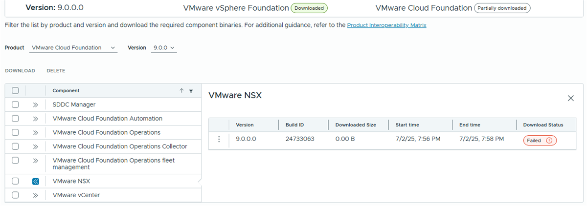

    Trying to spin up the Holodeckv9 and it fails using the Offline depot. I've downloaded the offline-depot OVA, deployed it and used a valid token to connect to the Broadcom URL.
    Took 3.5hrs to download binearies but when I point the VCF Installer to the offline depot and try to deploy a new instance it fails to download NSX.
    Pic attached. Any ideas why the offline depot would fail to pull the correct NSX binary? Anyone else seen this? All the other binaries were pulled down.
    Is there a simple fix or do i need to use the VCF download tool on a Linux box and manually transfer the correct binary?

  • 5.  RE: Holodeck v9 - Offline bundle depot NSX failed to download
    Posted 22 days ago
    Edited by G Kastelic 22 days ago
    Two problems, I think:
    -HTTP repo (and not HTTPS)
    -bug
    You need to allow HTTP in config file and change "InProgress" in .json file to trick installer to next step.
    https://williamlam.com/2025/06/using-http-with-vcf-9-0-installer-for-offline-depot.html
    https://vmware.github.io/Holodeck/release_notes/#workaround

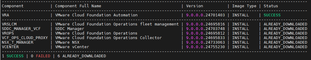

  • 6.  RE: Holodeck v9 - Offline bundle depot NSX failed to download
    Posted 23 days ago
    I also had error while downloading VRA, just re-run command and it resumed.
