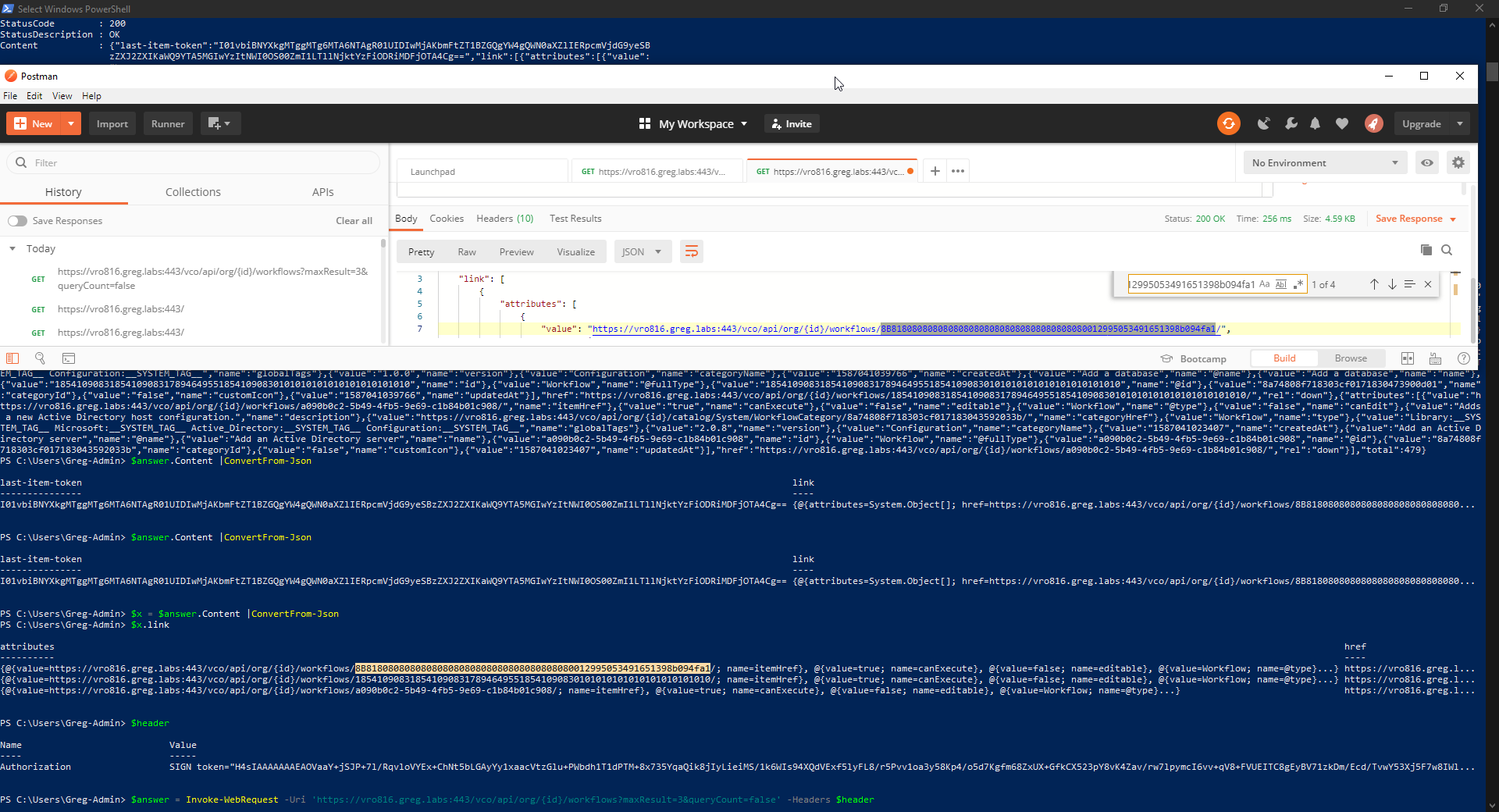

  • 2.  RE: HoK token for accessing vRO via REST call [powershell]
    Best Answer
    Posted May 18, 2020 11:31 AM
    Tiny update,
      i have received this description from support, correct form for Authorization header is :
    Description:
    token              REQUIRED. The SAML2 token identifying the caller. The value is calculated as BASE64(GZIP(SAML2)).
    nonce              REQUIRED. A unique string generated by the client allowing the server to identify replay attacks and reject such requests.
      The strings must be unique across all requests of a single client. The definition is as specified in Section 3.1
      of draft-ietf-oauth-v2-http-mac (http://tools.ietf.org/id/draft-ietf-oauth-v2-http-mac-00.txt) with one difference - the first component should be the current time expressed in
      the number of milliseconds since January 1, 1970 00:00:00 GMT with no leading zeros.
    bodyhash           OPTIONAL. A hash value computed as described in Section 3.2 of draft-ietf-oauth-v2-http-mac (http://tools.ietf.org/id/draft-ietf-oauth-v2-http-mac-00.txt) over the entire HTTP request
      entity body (as defined in Section 7.2 of RFC 2616(http://www.ietf.org/rfc/rfc2616.txt)). Note that the body hash may be missing only if there is no
      request body, i.e. empty body. Otherwise it is required.
    signature_alg      REQUIRED. The signature algorithm used by the client to sign the request - "RSA-SHA256", "RSA-SHA384" and "RSA-SHA512"
    signature          REQUIRED. A message signature calculated over the normalized request as
      BASE64(signature-algorithm(private key, request)). The request normalization is done
      as defined in Section 3.3.1 of draft-ietf-oauth-v2-http-mac (http://tools.ietf.org/id/draft-ietf-oauth-v2-http-mac-00.txt) with two exception - (a) the body hash is included without
      BASE64 applied and (b) no "ext" field is appended. All text based fields in the normalized request
      are encoded in UTF-8.
    There shouldn't be done any modification to the new lines , (in regards to the initial post where i was wondering if we have to get rid of \n). The token has to be passed entirely, including <saml2:Assertion>  tag. (this is what i was told by vmware support, so its bit different than in the post from 2015 on communities)
    Will be working now on getting the signature bits.
  • 3.  RE: HoK token for accessing vRO via REST call [powershell]
    Posted May 18, 2020 06:20 PM
    Update, i have completed the call, works 100%  i will rewrite the code to make it more pretty, and share later on.
