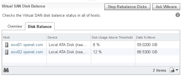

    I've recently setup a 3-node + witness (2 nodes contributing storage) vSAN cluster and I'm noticing that on all 3 physical hosts, the 'helper' process is at 100+%RUN.  What could be causing this and how can I troubleshoot to determine the cause?
    EDIT:  The one alert I see in the vSAN monitoring tab is 'VSAN Disk Balance' but when I manually kick off a rebalance nothing happens (just hangs at 5%).

    I'm running 6.0U2 on all ESXi hosts.  I kicked off a rebalance 3 hours ago and it's still running.  Don't see why it should take this long considering there isn't THAT much data to be moved.
    *Note*  When I first started the re-balance the Disk Usage Above Threshold %'s were 13% and 15% respectively so there was some initial movement but nothing since then.

    So the rebalance did finish at 24 hours as stated in those links.  However I still have the helper process using a lot of CPU on all 3 vSAN hosts.  The host outside the vSAN cluster hosting the vSAN Wtiness Appliance is running the helper process normally (very low CPU usage).
