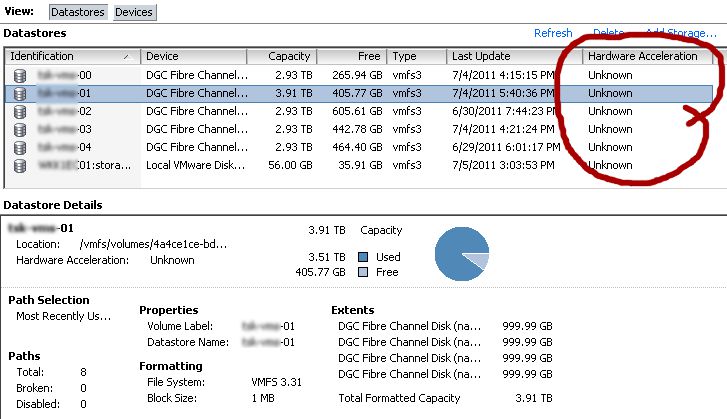

    But status of "Hardware acceleration" in the storage configuration of the ESX is still not changed:
    I tried to copy vmdk files on storages using ESX interface, cloned VMs...like it was written in the vmware FAQ but nothing happens.
    Does anyone have any thoughts? Just trying to understand why do I have such behaviour.

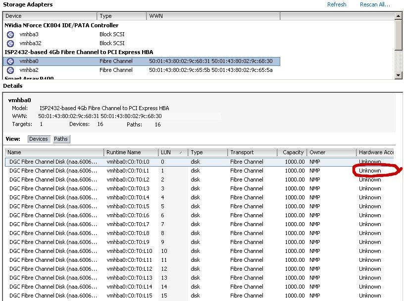

    Made a few tests...
    Looks like "HBA rescan" fixes information per LUN:
    If I go to the "Storage adapters" section I see the following information:

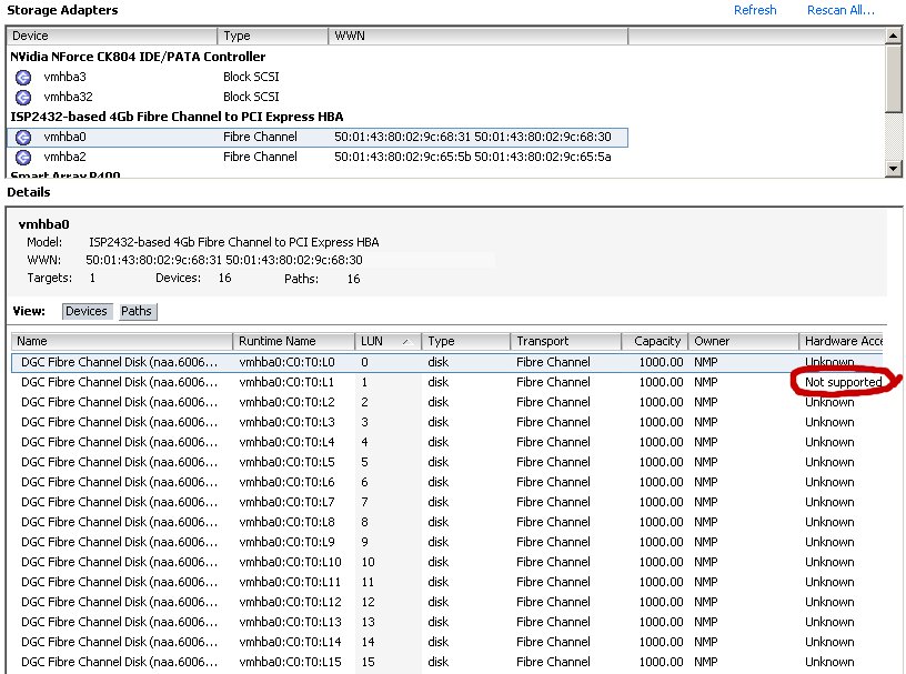

    But after rescaning the HBA adapters it changes to the following:
    But in the "Storage" section nothing changes, all hba in "Unknown" status.
    P.S. Looks like my SAN storage doesn't support VAAI, heh
