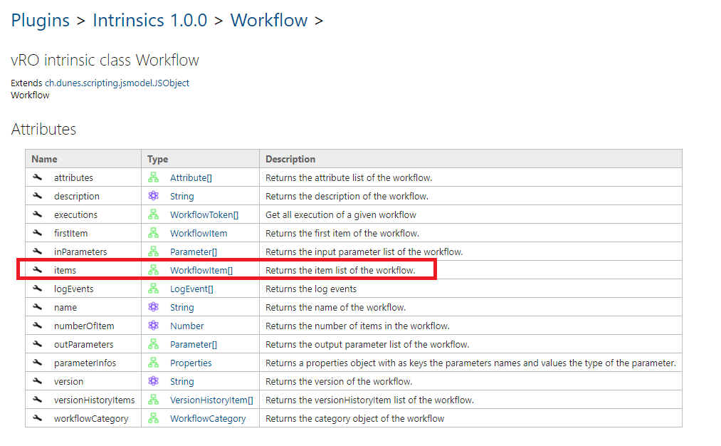

    In the workflow.currentWorkflow refers to the actual Workflow object

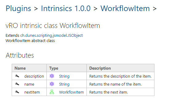

    This object has a list of items which refer to the components (scriptables, actions etc). Each of those have the following structure
    Given that each WorkflowItem has a link to the next item you *may* be able to come up with a way to walk the item tree and then work out which one you're currently in during execution? Not that promising sadly and would probably get very messy if the workflow has lots of branching......
