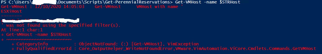

    I have a very strange issue with powercli command get-vmhost
    If I manually type get-vmhost and the fqdn of said host I can retrieve the details
    However, if I enter the fqdn into a string variable and use that I receive the following error:
    Any ideas as to what is happening?
    Many thanks

    I attach a copy of my script which is working well to retrieve RDM disks from various vcenter servers, you helped me with a lot of this, many thanks for your earlier help and sorry to pester you again with more
    Basically I sort the required results into an array called $FinalList and then perform some selections on the array to sort the associated hosts and disk devices into their respective vcenter servers
    These variables are then used within a foreach loop where each esxi host info is retrieved using get-vmhost but unfortunately falls over
    I attach the script to demonstrate or provide info, it is at line 84 where the array object of the esxihost is placed into the string variable $STRHost using out-string -inputobject
    $STRHost = Out-String -InputObject $HostSet
    Then I use 'get-vmhost $STRHost' and that is when I receive the error
    $LiveHost = Get-VMHost $STRHost
    $STRHost | get-member = system.string
    I attach my script for your perusal
    Many thanks in advance LucD

  • 6.  RE: get-vmhost will not accept string object?
    Best Answer
    Posted Oct 12, 2020 04:12 PM
    No problem.
    The issue is due to the Select-Object you use.
    An object that is produced by Select-Object is not intended for further assignments.
    Try changing line 81 to the following.
    The ExpandProperty makes sure you will just have the value, not a Select-Object object.
    $HostSets = $finallist | where {$_.vcenterserver -eq $VC} | select -ExpandProperty esxihost -Unique

    Posted Oct 13, 2020 07:42 AM
    Thanks LucD
    That was what I needed
