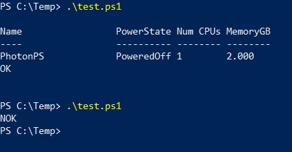

    The following is that exact code in a .ps1 file, without the Out-Null.
    1st run with an existing VM, 2nd run with a non-existing VM

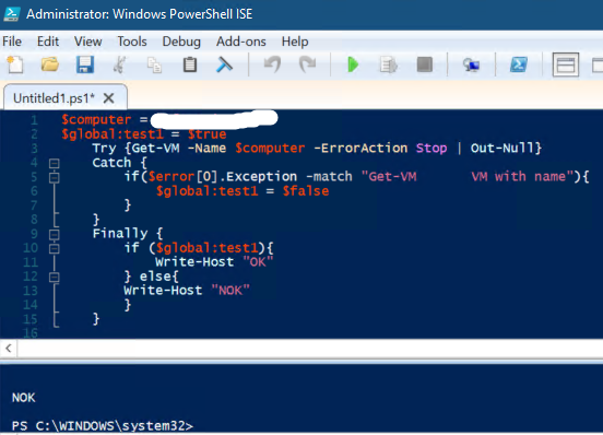

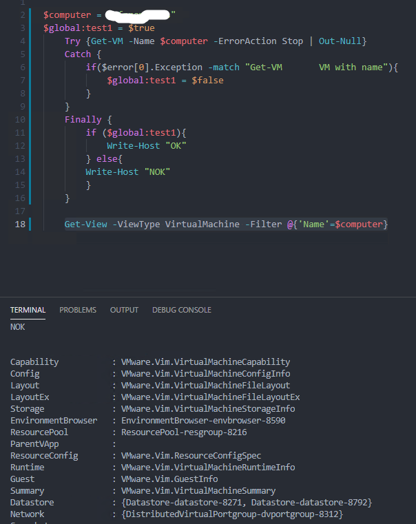

    Ok, I'm back. Apologies I accepted your post as a solution but it was by accident. So basically by declaring the global variable the Catch block is fixed and the loop flows fine. However, as reported in the original post it is the Get-VM that behaves dodgy. Look screenshot below:
    first run is from command prompt and the second from the panel. Same behavior in VS Code. If I run the whole block I get NOK which is wrong because the VM exists:

    So basically, there never was a question about Try-Catch
    You have a Get-VM for a specific VM that works one minute and doesn't work the next minute.
    I would first look at the reliability of the VCSA connection.
    You could also check if the Get-View shows the same behavior.
    Get-View -ViewType VirtualMachine -Filter @{'Name'=$computer}
  • 10.  RE: Get-VM throws error if inside Try function
    Posted Jan 04, 2021 11:12 AM
    well... the initial question has two queries, one for the Get-VM and the second for the Try/Catch. My bad for not using the global assignment and thank you for that!
    On the other side, if I use the Get-View the output is consistent and positive on each run. Regardless if run alone or inside Try/Catch..  if run together the Get-VM keeps getting NOK while Get-View works..
    Frankly I have no idea... I'll leave it and use the Get-View. Later I'll see on another machine but this one is THE scripts host for managing the VI. Thanks Luc..  I'll accept your workaround as a solution for now

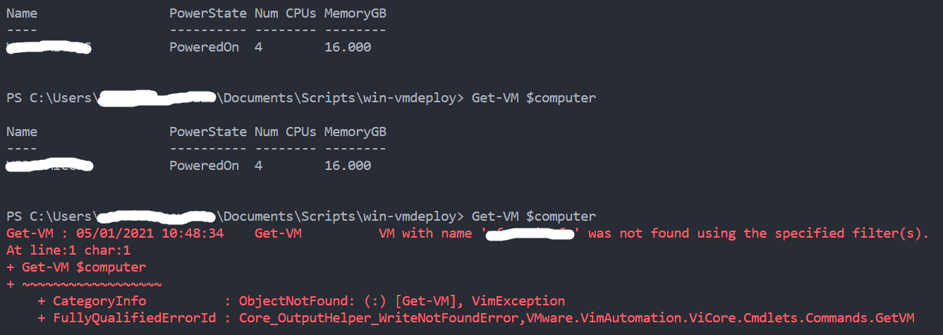

    Hi Luc, I am really really sorry to bother with this again. I certainly can go via the Get-View on newer scripts but I have plenty of other scripts that now won't work when executed from the IDE panel. Yes, I need to stress that if script runs execution works fine, it is just when executed from the IDE panel that the line Get-VM can either fail or succeed. It's just very annoying... because I'm working on orchestration kind of scripts and are rather long and intricated. So testing from panel is essential for me!  From what I searched on Google I don't see similar cases so it "seems" this is a problem I'm experiencing. I tried your advice and installed latest powercli on 3 different machines (one of which freshly installed) with the following PS versions:
    Name Value
    PSVersion 5.1.19041.610
    PSEdition Desktop
    Name Value
    PSVersion 5.1.17763.1490
    PSEdition Desktop
    Name Value
    PSVersion 5.1.14393.3866
    PSEdition Desktop
    The PowerCLI modules all go to the C:\Program Files\ path. The three hosts give the same result. If I select Get-VM $computer and click on F8 I get a response that can be positive or negative and if I keep pressing F8 the response is always the same. If I stop and simply select again the same line and run F8 again I get the same or opposite response. I tried this on ISE and VS Code..  any other suggestion??  My apologies again for persisting with this...

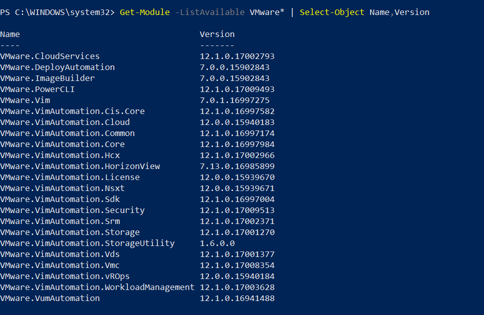

    these the modules installed:
  • 19.  RE: Get-VM throws error if inside Try function
    Posted Jan 05, 2021 11:31 AM
    Those are currently the latest versions of the PowerCLI modules.

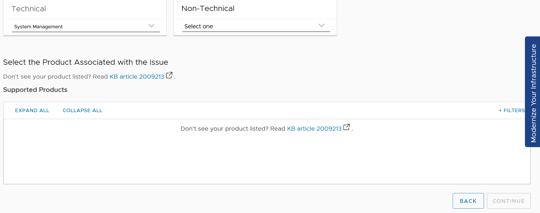

    also in the GSS web I can't find the PowerCLI listed in the products.. am I in the wrong place?
    https://my.vmware.com/group/vmware/get-help?p_p_id=getHelp_WAR_itsupport&p_p_lifecycle=0&_getHelp_WAR_itsupport_execution=e3s2
    I followed the vmware support breakdown for PowerCLI but I have no choice to select from, and the Next button is greyed out as a consequence...
  • 25.  RE: Get-VM throws error if inside Try function
    Posted Jan 06, 2021 10:38 AM
    The  PowerCLI Support Breakdown post states
    • Open a support request for the product area where the failure is occurring
    so in your case, that would be System Management I guess.
