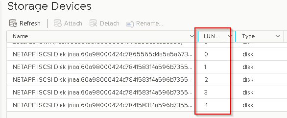

    LucD,
    I was referring LUN ID or LUN number to below screenshot
  • 4.  RE: Get vCenter, Cluster, Host and LUN ID in the output
    Posted Jul 28, 2020 12:26 PM
    Try like this
    $clusterName = 'Compute'
    $report = @()
    Get-Cluster -Name $clusterName -PipelineVariable cluster |
    Get-VMHost -PipelineVariable esx |
    ForEach-Object -Process {
        $esxcli = Get-EsxCli -VMHost $esx -V2
        $esxcli.storage.vmfs.extent.list.invoke() | %{
            $obj = $esxcli.storage.core.device.list.CreateArgs()
            $obj.device = $_.DeviceName
            $path = $esxcli.storage.core.path.list.Invoke($obj)
            $esxcli.storage.core.device.list.Invoke($obj) |
                $report += Add-Member -InputObject $_ -MemberType NoteProperty -Name vCenter -Value (([uri]$esx.ExtensionData.Client.ServiceUrl).Host) -PassThru |
                    Add-Member -MemberType NoteProperty -Name Cluster -Value $cluster.Name -PassThru |
                    Add-Member -MemberType NoteProperty -Name VMHost -Value $esx.Name -PassThru |
                    Add-Member -MemberType NoteProperty -Name LUN -Value $path.LUN -PassThru
    $report | Select Device,Size,NoofoutstandingIOswithcompetingworlds | ft -auto
