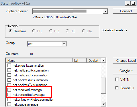

    OK thanks.  I wrongly assumed I could do this with only statistics level 1 enabled.  What if I were to be willing to be content with just realtime metrics, could I run a script that would create a snapshot of the above requirements just for the present moment and get a rough idea what was happening at a given moment?
  • 4.  RE: get-stat network script
    Posted May 22, 2015 08:27 PM
    Yes, these are available in the Realtime interval (for +/- 1 hour), but only transmitted and received, not the aggregated throughput.
    As you can see with my Stats Toolbox :smileygrin:
    To get the throughput value, just do a summation of these 2

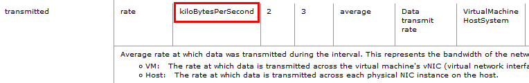

    OK great.  Is net.received.average measured in units of percentage, or in units of Kbps?  (In order for this to work I have to be able to get the value in Kbps / Mbps)
  • 6.  RE: get-stat network script
    Posted May 22, 2015 08:42 PM
    In KBps, see the PerformanceManager table.

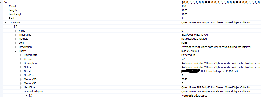

    OK thanks - ran this code and looked at the instance property
    $a = get-stat -entity (get-vm vm100) -stat net.received.average -realtime
    Under $a -> syncroot -> [1] -> instance
    I see this: vmnic0
    vmnic0 uplink that provides connectivity to a port group.  I'm not sure it would help to get statistics on that because that vmnic carries traffic for every VM on the port group.
    what I am trying to find is the traffic statistics for the virtual machines own vmxnet3 network adapter 1, and distinguish that from networkadapter2.
    For example, I see the network adapter 1 in the following location:
    $a -> syncroot -> [1] -> entity -> networkadapters -> [1]
    Is it possible to get traffic just on this networkadapter1?
    I see a "value" field for the object as a whole in the property inspector, but I don't see a "value" field associated with the individual network adapter.
    Any ideas?
