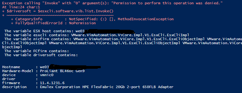

    $ESXHost = get-vmhost "myhost"
    $esxcli = Get-EsxCli -vmhost $ESXHost
    $esxcli.storage.san.fc.list()
  • 14.  RE: Get HBA firmware and driver version for all ESXi hosts
    Posted Sep 11, 2020 05:53 PM
    Hi,
    I found this script on one of the online forums, but first you have to have PowerCli 6.5 or later.
    1- Start PowerCli.
    2- Connect to your vCenter using Connect-VIServer command.
    3- Copy the below script to a notepad file and then rename it to .ps1
    4- From the PowerCli shell, go to the destination of your ps1 script and then execute.
    This script has exported HBA and VNICs firmware and driver versions info for all of my HPE ESXI hosts.
    If you want specific cluster or specific host, change the first line of the script with one of the following;
    Example:
    $vmhosts = Get-VMHost fqdn-of-your-esxihost - Check a single Host
    $vmhosts = Get-Cluster you-cluster-name | Get-VMHost - Checks all hosts in a cluster
    $vmhosts = Get-VMHost - Checks all hosts in the vCenter
    Script is below:
    $report = @()
    foreach ($ESXHost in $vmhosts) {
        $nicfirmware = $esxcli.network.nic.list()
        $fcfirmware = $esxcli.storage.san.fc.list()
        $driversoft = $esxcli.software.vib.list()
            foreach($nicfirmwareselect in $nicfirmware)
                    $NetworDescription = $nicfirmwareselect.Description
                    $NetworDriver = $driversoft | where { $_.name -eq ($nicfirmwareselect.Driver) }
                    $NetworkName = $nicfirmwareselect.Name
                    $NetworkFirmware = ($esxcli.network.nic.get($nicfirmwareselect.Name)).DriverInfo.FirmwareVersion
                    $report += "" |
                    select @{N = "Hostname"; E = { $ESXHost.Name } },
                    @{N = "Hardware-Model"; E = { $ESXHost.Model } },
                    @{N = "device"; E = { $NetworkName } },
                    @{N = "driver"; E = { $NetworDriver.Version } },
                    @{N = "firmware"; E = { $NetworkFirmware } },
                    @{N = "description"; E = { $NetworDescription } }
            foreach($fcfirmwareselect in $fcfirmware)
                    $fcDescription = $fcfirmwareselect.ModelDescription
                    $fcDriver = $driversoft | where { $_.name -eq ($fcfirmwareselect.DriverName) }
                    $fcName = $fcfirmwareselect.Adapter
                    $fcFirmware = $fcfirmwareselect.FirmwareVersion
                    $report += "" |
                    @{N = "device"; E = { $fcName } },
                    @{N = "driver"; E = { $fcDriver.Version } },
                    @{N = "firmware"; E = { $fcFirmware } },
                    @{N = "description"; E = { $fcDescription } }
    $report | Export-Csv -Path 'C:\ESXI HBA & NIC info.csv'
    $report = @()
                    $report += "" |
                    $report += "" |
    $report | Export-Csv -Path 'C:\Users\505000367110\Desktop\hba-info.csv'

     Here are variables output. also, I'm getting permission denied message. What all the permissions needed to use below cmdlet and to call below methods.
    Get-EsxCli
    $esxcli.network.nic.list.Invoke()
    $esxcli.storage.san.fc.list.Invoke()
    $esxcli.software.vib.list.Invoke()

    Posted Apr 14, 2021 06:52 AM
    Like I said earlier, there is not a lot I can do remotely.
    It looks odd that you now all of a sudden have a permission error.
    You will have to debug this yourself, since it seems to be something specific to your environment.
  • 28.  RE: Get HBA firmware and driver version for all ESXi hosts
    Posted Apr 14, 2021 01:33 PM
     finally I was able to fetch the HBA firmware/Driver version details after connecting to vsphere.local super user. I just want to know which permissions are required to be able to execute below methods using ADS user. Kindly advise.
