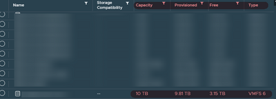

    Hi,
    I have used the script and got the following output on my selected datastore
    Capacity (GB)    : 10239,75
    FreeSpace (GB)   : 3228,69
    Overprovisioned% : 98,1
    Freespace%       : 31,5
    Provisioned (GB) : 10046,6
    This is the image i get when adding a disk (which shows the overprovisioning) from VCenter 7
    Excuse my ignorance but i'm very confused about the results and what do they actually means in terms of "getting the LUN dead"
    From the screenshot my logic says that the capacity is 10TB i have provisioned 9.81 TB and the Free is 3.15TB which accordind to math 9.81+3.15=12,96 it is over 10TB so you are in a bad position.
    From the excellent script of LucD a get the %of overprovisioned to be 98.1 which what does it mean it is below 100%, is it overprovisioned ?
    What is my margin here ? the freespace% 31% means what? is this the 3.15TB the 31.5% freespace% ?
    Does this mean that when the thin disks allready on the VMs grow 10TB-9.81TB (from the image) =190GB more the lun will be full and stopped working.
