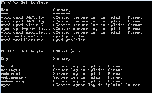

    Perhaps useful to know, with the Get-Log cmdlet you can retrieve logs from ESX(i) servers and the vCenter server.
    When you add the -VMHost parameter you will get ESX(i) logs, without that parameter you will get vCenter logs.
    The Get-LogType cmdlet will tell you which logs are available in both cases, ESX(i) and vCenter.
    You use the Key parameter with one of the Key values listed above to fetch a specific log.
