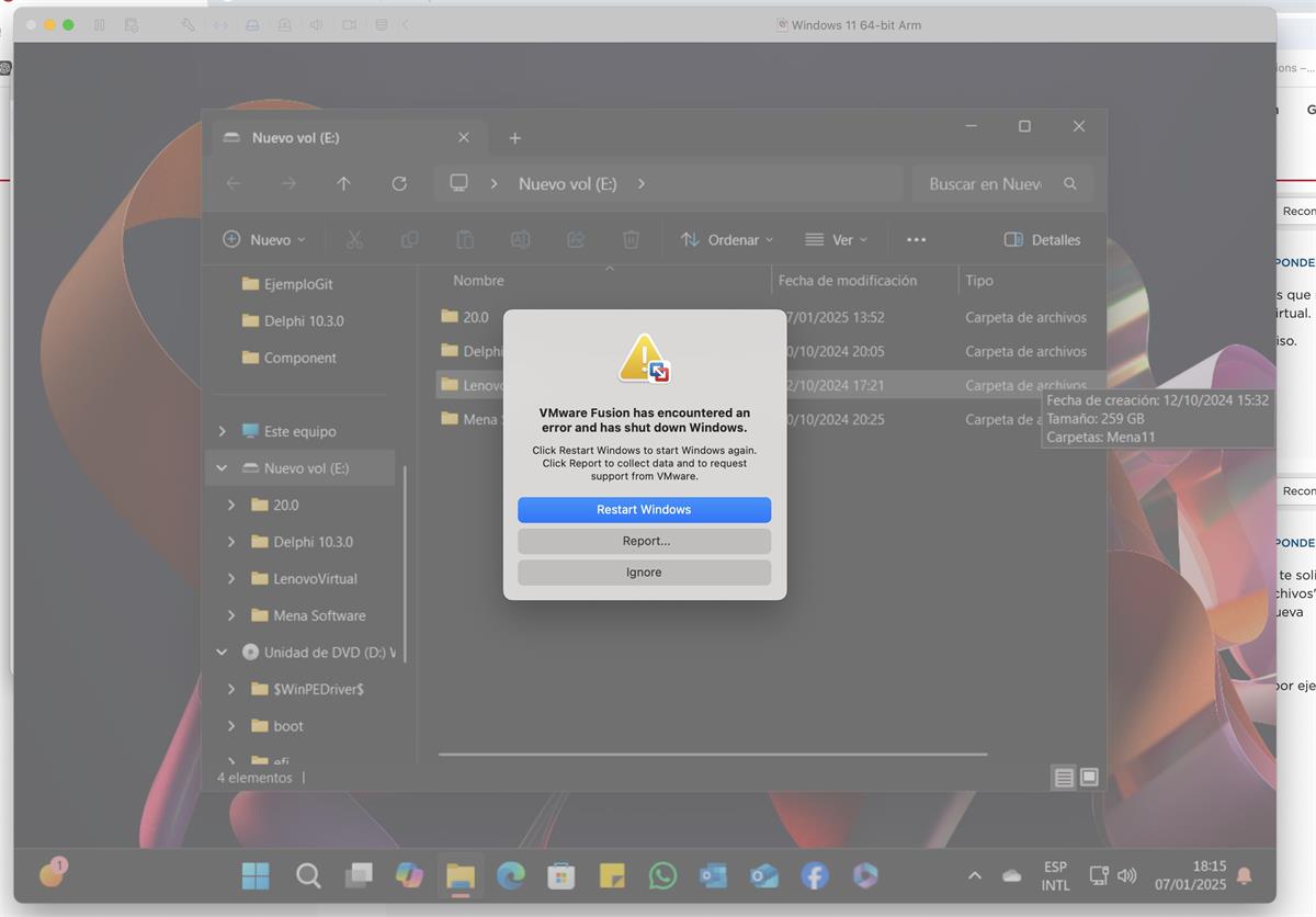

Fussion error and has shutdown Windows.

    I have MacBook Pro M2 Max
    and a virtual machine with Windows 11 64bit ARM

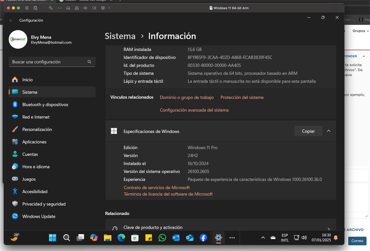

    What version, channel, and build of Windows are you running in the VM? Is this a GA/release channel build or an Insider Preview channel (Beta/Dev/Canary) build?

    • What version of Windows 11 ARM are you using (version -- e.g. 24H2 and -- build number - e.g. 26100.2605).

    This is very strange, because I am seeing that it is configured like this, and even so, it keeps giving me this error, what I am thinking is to remove the encryption
    error

    How long does the VM run before giving you the ".
    Thanks for the Windows version and build. You're running the latest 24H2 (26100.2605) - the latest release channel version. What Windows language did you use for installation? From what I'm seeing Windows says it's using Spanish (International) so I'm going to give this a try with the Spanish language ISO download.

    Is a USB External. I deleted completely to make it again.

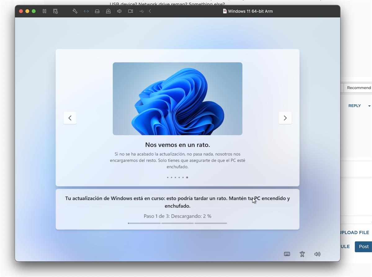

    Now, i'm trying install it again, let you know what happen.
    reinstall
